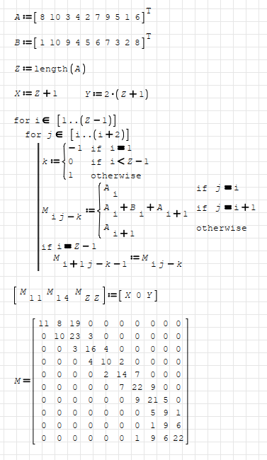

This algorithm should do it.
Just replace X,Y values and A,B matrices with yours.
Don't know what your 999 row is, so I have improvised.
fillmatrix.sm (12.66 KiB) downloaded 1151 time(s).

I have tried your algorithm on my data and it seems to work. I checked it on a 38 x 38 matrix and it does the job perfectly.
Unfortunatelly I am not able to use it for my purposes because it takes forever to execute for bigger matrices... My final matrix is not 1000 x 1000 - it's 2688 x 2688 and for this matrix the algorithm did not complete for 15 minutes (I have terminated calculations after this time). It did not complete for 1000 x 1000 as well (but in this case I have terminated calculations after 5 minutes). Is there anything I can do to speed it up?
Please find my file with necessary data attached below.

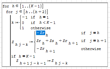

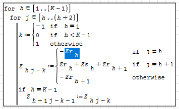

Hi Xylene. First of all, try not to use i if you are going to use complexes, as you would be redefining it, and i is not a protected or special variable, like in Mathcad or other CAS.
Next, notice that in this version of the lasso the opposite of the entire vector is first found, and then the element is selected.
while in this other one the element is first selected and then the opposite is found
Yes, they look the same, but they are not. These improvements bring the code to a few seconds for a few values, but it's still slow for the larger array.

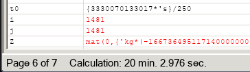

Maybe this is a silly (and off-topic) question but how can I check on what stage is the program in calculations? Where does that information i = 821 after 12 mins come from?
I know that there is a green progress bar in the bottom right corner, but this bar shows only the number of current operation and not the number of iteration in current operation.
PS pausing the program causes error and results in shuting it down.

I simply paused it. In debug panel I looked for i value.
It was 821 while time was around 12 minutes at bottom bar.
I use linux, SMath doesn't crash on me when I pause the process.

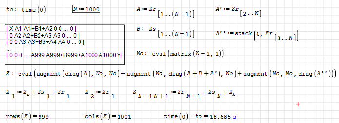

My grain of sand. The described algorithm does not return a square matrix, but one with two more columns than rows. This would be the most efficient way to calculate it.
