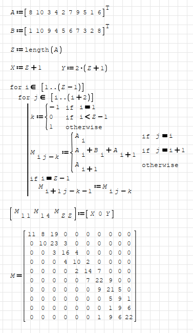

This algorithm should do it.
Just replace X,Y values and A,B matrices with yours.
Don't know what your 999 row is, so I have improvised.

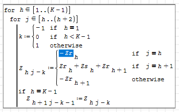

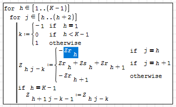

Hi Xylene. First of all, try not to use i if you are going to use complexes, as you would be redefining it, and i is not a protected or special variable, like in Mathcad or other CAS.
Next, notice that in this version of the lasso the opposite of the entire vector is first found, and then the element is selected.
while in this other one the element is first selected and then the opposite is found
Yes, they look the same, but they are not. These improvements bring the code to a few seconds for a few values, but it's still slow for the larger array.

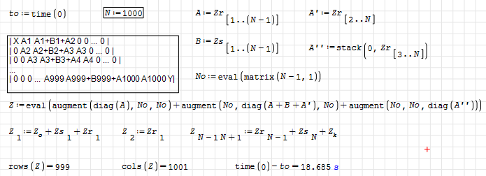

Finally you could try using diag to fill a matrix with the diagonal values, and augment(0,diag(X)) or stack(0,diag(X)) to create subdiagonal or similar matrices and add to the diagonal matrix. In theory that should be the most efficient way to build the Z matrix.

Using diag() and submatrices sure speed things up.
Not that fast enough (5 mins), but it finished at least.
Previous solution was still at i=821 after 12 mins when I paused it.
Maybe someone make it even faster, that's all I can do for now.
Here is your file with new algorithm.
Matrix_diag.sm (114.43 KiB) downloaded 1370 time(s).

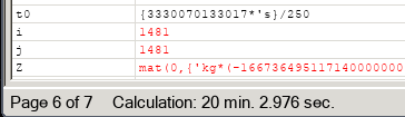

Monitor your ram usage while running algorithm
That's what come into my mind with info I have.
PS: I rerun my bad code, it was just past half of your data.
And it took 20 mins to get there, don't use file with for() algorithm.
Use the one with diag(), it completes in 4 minutes.
