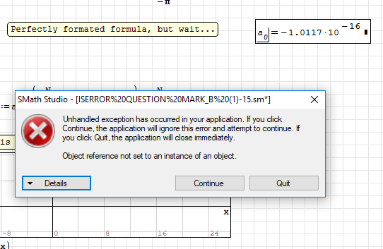

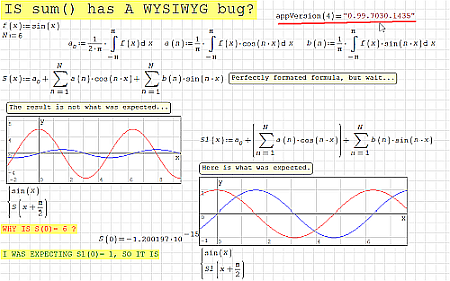

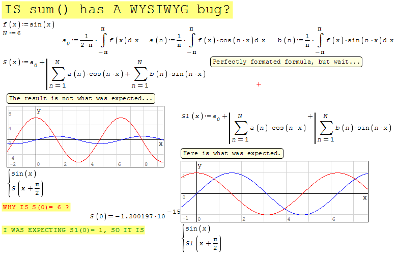

Attached sm file which appeared recently in the forum works in 7030 (stable), but throws errors in 7067 (Beta).
Some times it crashes when trying to evaluate some variables.
ISERROR QUESTION MARK_B (1).sm (18.72 KiB) downloaded 1307 time(s).
#2 Posted: 2019/5/11 03:32:48
Confirmed,
Sometimes crashed (red cross over the screen) and sometimes didn't.

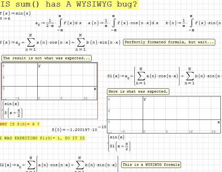

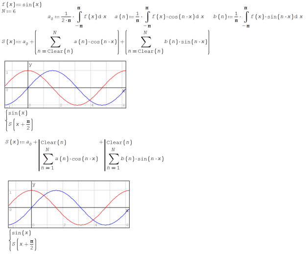

#3 Posted: 2019/5/11 04:24:41
1,123 likes in 1,795 posts.
Hi. I don't see a bug here, but some kind of issue handling n. About the WYSIWYG notation, it's well know this kind of difficulties not only in SMath, but in mathcad, maple and mathematica too. About the issue with n it must to be solved using Clear, because n isn't local in the sum.
ISERROR QUESTION MARK_Clean.sm (10.4 KiB) downloaded 1300 time(s).

#4 Posted: 2019/5/11 05:04:17
Thank you Alvaro, you are right
This problem with summation will come up here and there. It would be enough to put the summation terms inside a single line environment. This behaviour is present in SMath for quite a while. This is easy to forget, but it should not have crashed in those cases. The problem is how to remember this issue and overcome situations like this one.

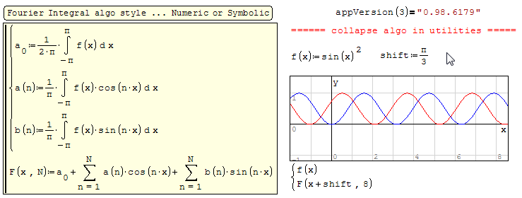

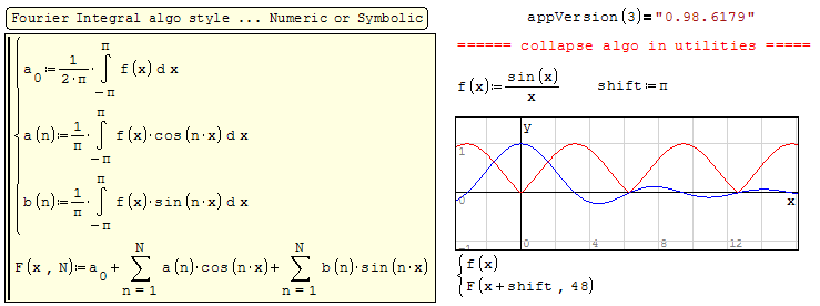

Try this Fourier-algo style.
Fourier Integral Algo Style.sm (7.66 KiB) downloaded 1250 time(s).

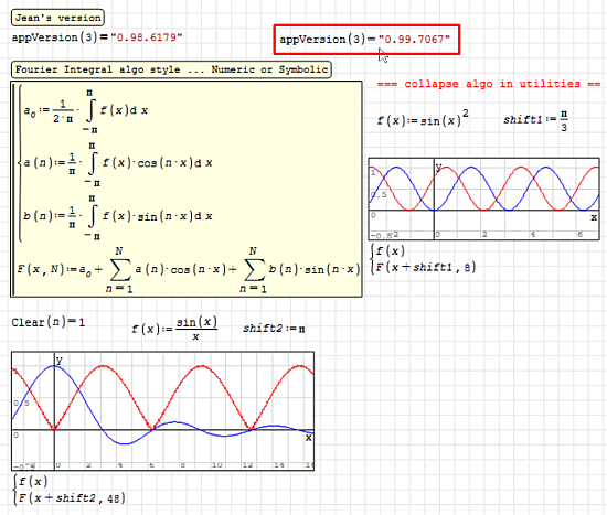

Leave default integral acc 100, only 'N'
Rejects SQRT(x) but takes SQRT|(x)|
Try more ... let us know about your version ... Jean
Thank you Jean.

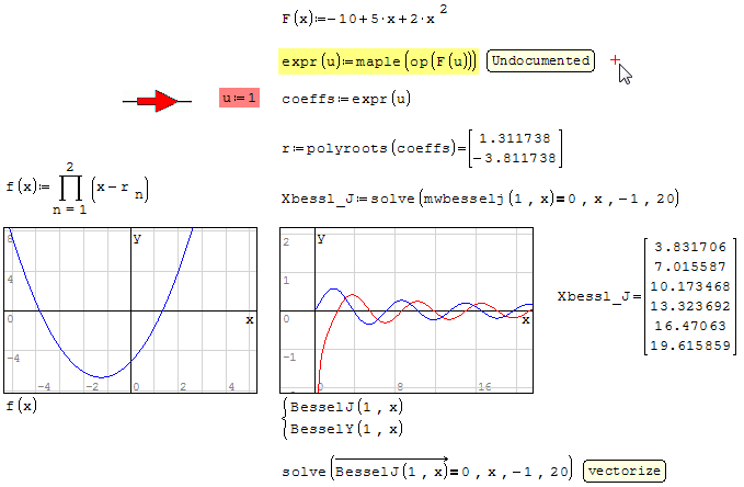

The attached sm file also crashes some times when inputs to Polyroots, solve, maple(solve)
are changed or adjusted.
Roots_Ex1.sm (16.06 KiB) downloaded 1209 time(s).

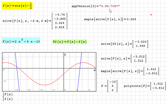

#10 Posted: 2019/5/12 04:44:58
Tried but it did not crash.

#12 Posted: 2019/5/12 10:37:18
That shouldn't happen, but maybe on latest beta.
1. Polynomials have unique Lagrange format [lot many books are wrong].
2. maple(op(F(u))) will save you manual steps and possible typo errors.
Maths eigenAll Companion.sm (62.14 KiB) downloaded 1208 time(s).

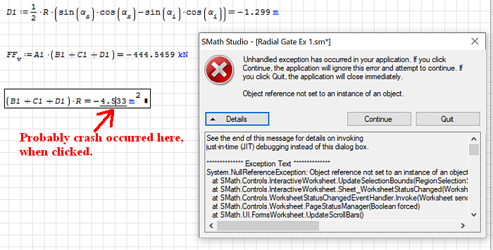

#14 Posted: 2019/5/13 01:01:52
NDTM Amarasekera
NDTM Amarasekera
130 likes in 352 posts.
Please remember to copy and attach here the stack traces when you encounter such critical errors, especially if they are not easily reproducible like this.

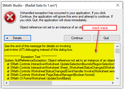

Even after a Clean Re-installation, crashes continued to occur on and off.
Attached sm file crashed when I was doing some changes to either default units,
or copying etc. (I'm not sure). Note where I clicked.
Radial Gate Ex 1.sm (194.77 KiB) downloaded 1188 time(s).
#15 Posted: 2019/5/13 06:00:09
NDTM Amarasekera
NDTM Amarasekera

Second crash. BTW how do I create stack traces and copy?
Radial Gate Ex 1.sm (195.59 KiB) downloaded 1234 time(s).

#16 Posted: 2019/5/13 06:54:36
1,443 likes in 2,935 posts.
Still not able to reproduce but at least we have an hint.
Simply copy the text from the error window

Third crash occurred, and the stack traces (in MS Word) attached.
Radial Gate Ex 1.sm (195.59 KiB) downloaded 1172 time(s).
7067 3rd Crash-Stack Traces.docx (18.08 KiB) downloaded 740 time(s).
