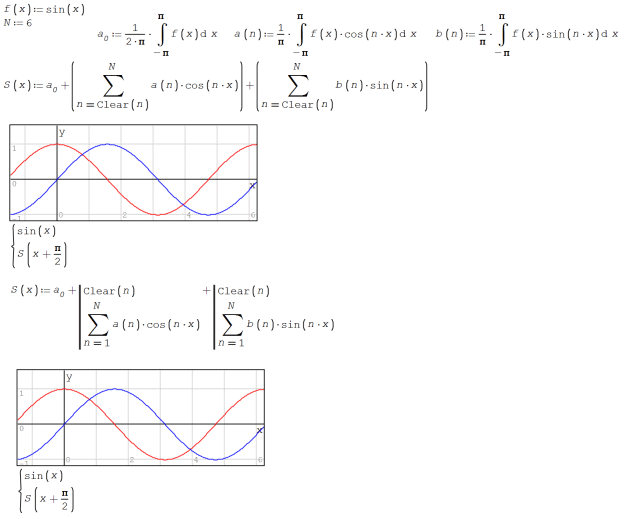

Attached sm file which appeared recently in the forum works in 7030 (stable), but throws errors in 7067 (Beta).
Some times it crashes when trying to evaluate some variables.
ISERROR QUESTION MARK_B (1).sm (18.72 KiB) downloaded 1464 time(s).

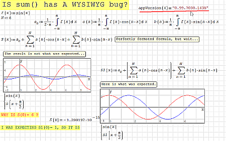

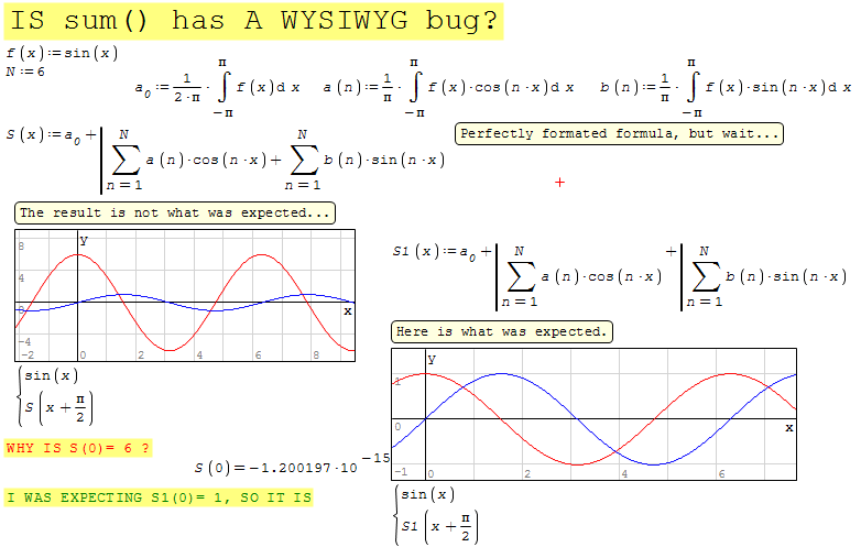

Hi. I don't see a bug here, but some kind of issue handling n. About the WYSIWYG notation, it's well know this kind of difficulties not only in SMath, but in mathcad, maple and mathematica too. About the issue with n it must to be solved using Clear, because n isn't local in the sum.
ISERROR QUESTION MARK_Clean.sm (10.4 KiB) downloaded 1469 time(s).
4 users liked this post
sergio 5/11/2019 4:33:00 AM, NDTM Amarasekera 5/11/2019 11:25:00 AM, frapuano 5/11/2019 5:32:00 AM, Radovan Omorjan 5/11/2019 4:51:00 AM

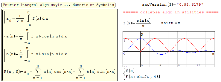

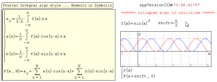

Try this Fourier-algo style.
Fourier Integral Algo Style.sm (7.66 KiB) downloaded 1405 time(s).
NDTM Amarasekera 5/11/2019 1:15:00 PM
#6 Posted: 5/11/2019 12:30:37 PM
Leave default integral acc 100, only 'N'
Rejects SQRT(x) but takes SQRT|(x)|
Try more ... let us know about your version ... Jean

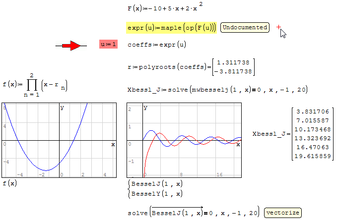

but it should not have crashed in those cases. The problem is how to remember this issue and overcome situations like this one.

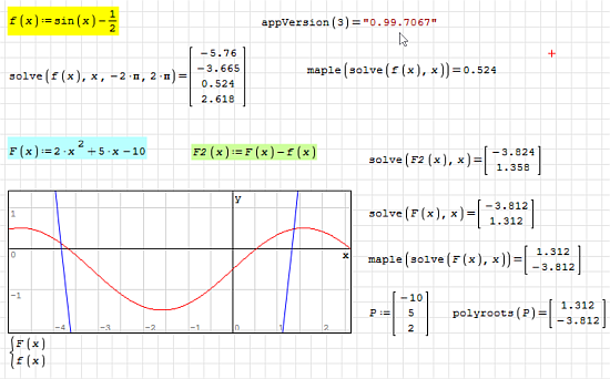

The attached sm file also crashes some times when inputs to Polyroots, solve, maple(solve)
are changed or adjusted.
Roots_Ex1.sm (16.06 KiB) downloaded 1384 time(s).

Tried but it did not crash.
That shouldn't happen, but maybe on latest beta.
1. Polynomials have unique Lagrange format [lot many books are wrong].
2. maple(op(F(u))) will save you manual steps and possible typo errors.
Maths eigenAll Companion.sm (62.14 KiB) downloaded 1367 time(s).

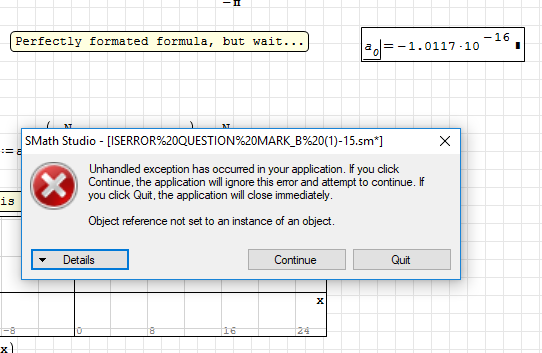

Please remember to copy and attach here the stack traces when you encounter such critical errors, especially if they are not easily reproducible like this.

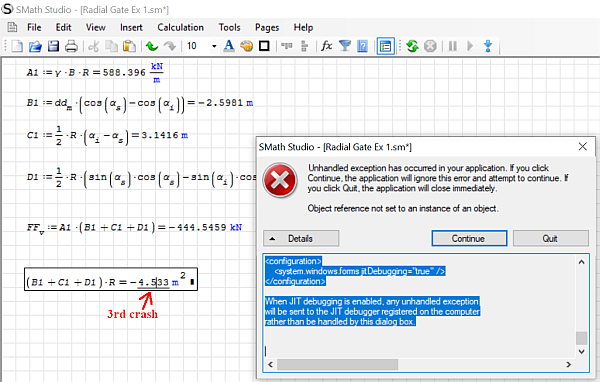

#14 Posted: 5/13/2019 1:01:52 AM
NDTM Amarasekera
NDTM Amarasekera
130 likes in 352 posts.
Even after a Clean Re-installation, crashes continued to occur on and off.

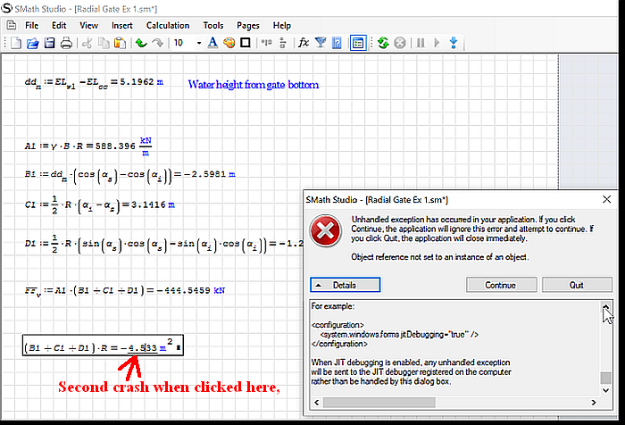

Attached sm file crashed when I was doing some changes to either default units,
or copying etc. (I'm not sure). Note where I clicked.
Radial Gate Ex 1.sm (194.77 KiB) downloaded 1343 time(s).

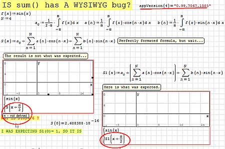

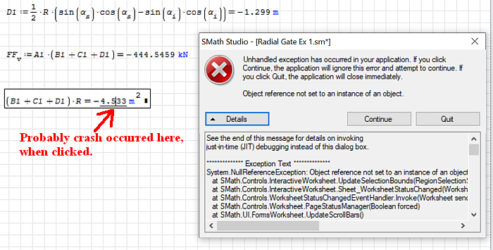

Second crash. BTW how do I create stack traces and copy?
Radial Gate Ex 1.sm (195.59 KiB) downloaded 1394 time(s).

#17 Posted: 5/13/2019 8:13:42 AM
NDTM Amarasekera
NDTM Amarasekera
Thanks Davide.

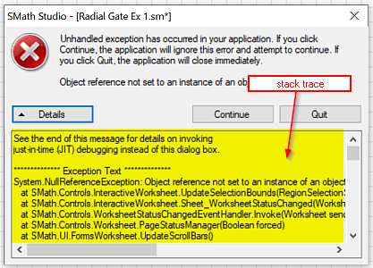

Third crash occurred, and the stack traces (in MS Word) attached.
Radial Gate Ex 1.sm (195.59 KiB) downloaded 1332 time(s).
7067 3rd Crash-Stack Traces.docx (18.08 KiB) downloaded 849 time(s).
#18 Posted: 5/13/2019 10:59:12 AM
In 4 years Smath I have observed ONE crash from a corrupted region.
Same in 15 years Mathcad , but several times MCD. Corrupted region
has no explanation. The only cure found was to re-code piece wise
on blank sheet. You could try to isolate the components ...
B1:=B1, C1:=C1 ...etc. even transit via spool to file.
That it crashes by clicking on result once displayed has no other
explanation than critical error, from unknown cause.
Sorry Collab: can't help more, it looks a bug wrt latest beta.
