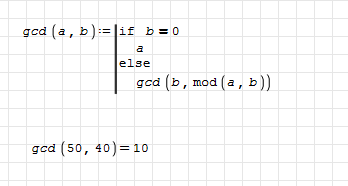

WroteI'm not sure, but I think I might have found a bug:
I remember this used to work before. Am I doing something wrong?
You need to use line operator in function definition.
![2022-11-30 07_40_07-SMath Solver - [Worksheet1_].png](/zh-Hans-CN/files/Download/BAc5be/2022-11-30-07_40_07-SMath-Solver---[Worksheet1_].png)

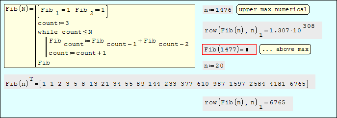

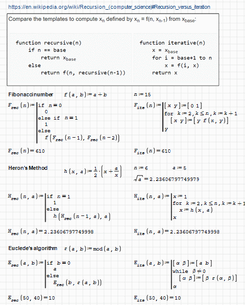

WroteMaths Sqrt(x) Heron DEMO.sm (11.66 KiB) downloaded 1389 time(s).
Either.
recursive_versus_iterative.sm (40.78 KiB) downloaded 1435 time(s).
