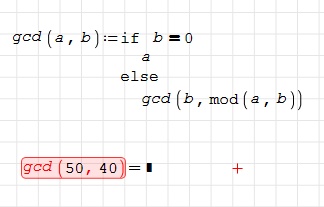

WroteI'm not sure, but I think I might have found a bug:
I remember this used to work before. Am I doing something wrong?

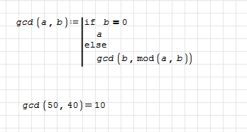

You need to use line operator in function definition.
![2022-11-30 07_40_07-SMath Solver - [Worksheet1_].png](/ru-RU/files/Download/BAc5be/2022-11-30-07_40_07-SMath-Solver---[Worksheet1_].png)

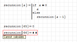

Edit: A note about recursion. I do believe that Andrey limited the recursion depth that can take place. I think its somewhere around 50.
sergio 30.11.2022 11:16:00
Hi. Every CAS should have a recursion limit. The point would be to be able to control it, like in Mathematica: https://reference.wolfram.com/language/ref/$RecursionLimit.html

Thanks!! How did I forget that. heh.

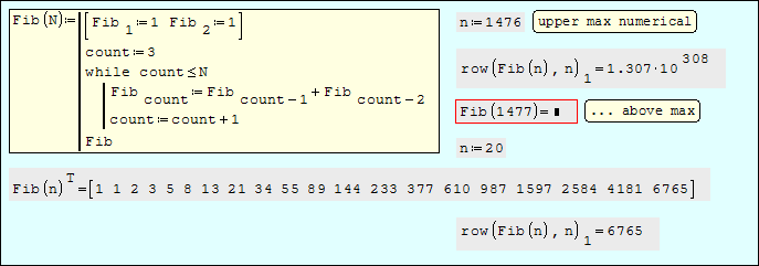

Maths Sqrt(x) Heron DEMO.sm (11,66 КиБ) скачан 1598 раз(а).
WroteMaths Sqrt(x) Heron DEMO.sm (11,66 КиБ) скачан 1598 раз(а).

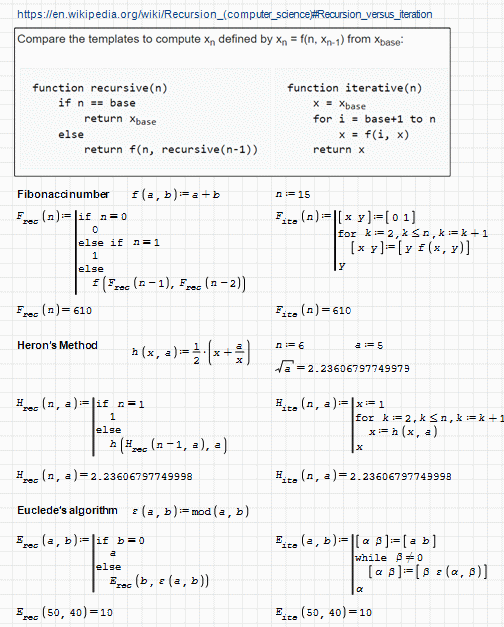

Either.
recursive_versus_iterative.sm (40,78 КиБ) скачан 1668 раз(а).
