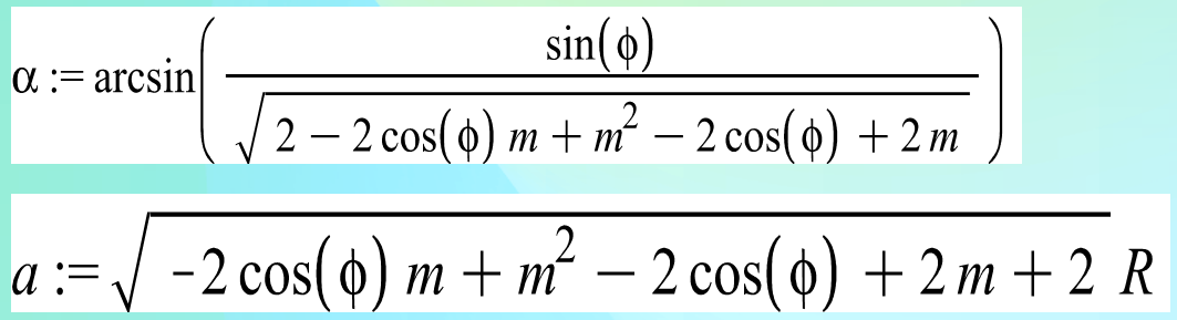

My friend use Maple to get symbolic solution like this
You can see that in the solution of alpha, there is no a, in the solution of a, there is no alpha.

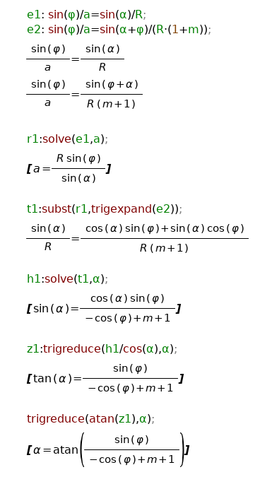

#4 Posted: 2022/2/20 20:29:51
598 likes in 1,380 posts.
Symbolic solver of maxima is not that capable.
As far as I know of course, maybe there is a simpler way.
But this statement was what I had read about it.
You have to use some substitutions for that solutions.
And some extra division, arc functions, visa versa.
Here is α solved symbolically in wxMaxima.
Same method can be applicable for variable a.
untitled.wxmx.zip (1.6 KiB) downloaded 315 time(s).

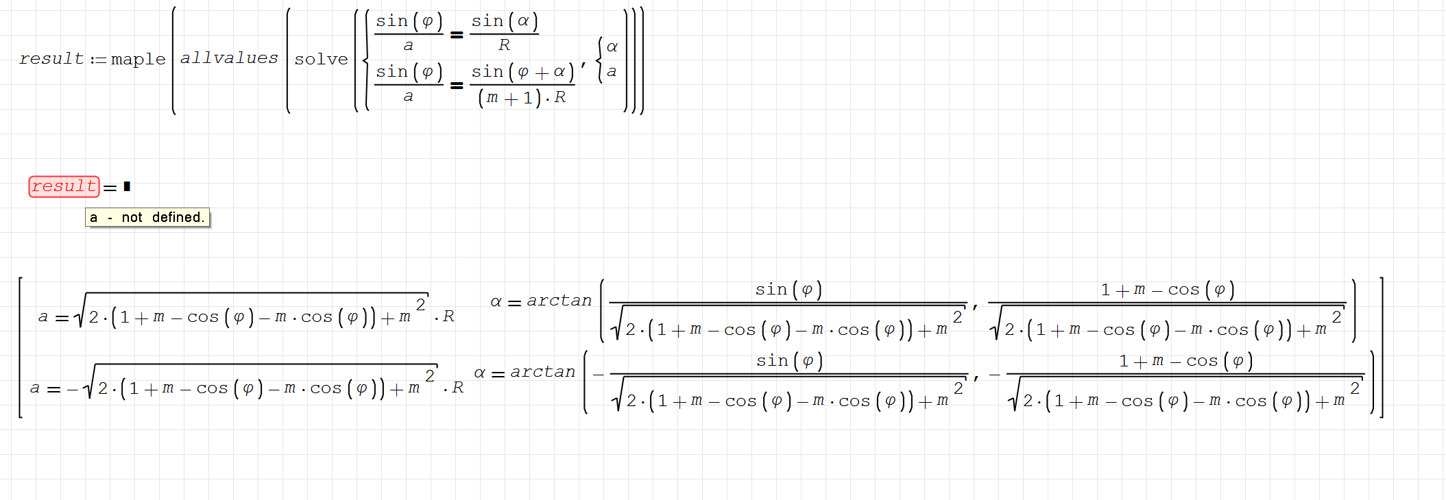

Is Maple plugin in Smath able to get symbolic results as Maxima does, but more easily?
#7 Posted: 2022/2/22 11:55:34
Maple is easier to use, that is a fact.
And sometimes it gives better results.
But Maxima can surpass Maple at certain aspects.
Use what suits your needs most.
In the example below, I solved your function with Maple.
Though it gives the results correct, result matrix is cripled.
Copying and changing last bits of result ";2;1)" to ";2;2)" will correct the result.
";" may differ to "," according to your arguments separator.
Worksheet1.sm (15.97 KiB) downloaded 1148 time(s).

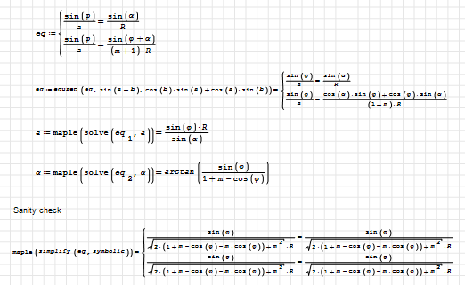

#11 Posted: 2022/4/16 12:43:00
1,123 likes in 1,795 posts.
Hi. Another way, applying trigonometric identities.
solve_trig.sm (12.03 KiB) downloaded 1103 time(s).
