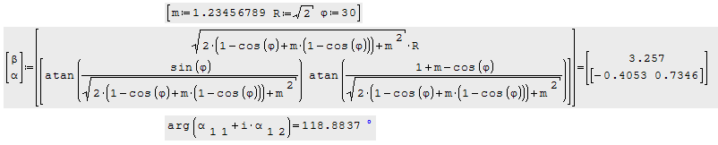

Thanks Jean,
Both a and alpha are unknows.
the result of a and alpha are still includes these unknows.
Only φ, R and m are knowns and can be used in the results.

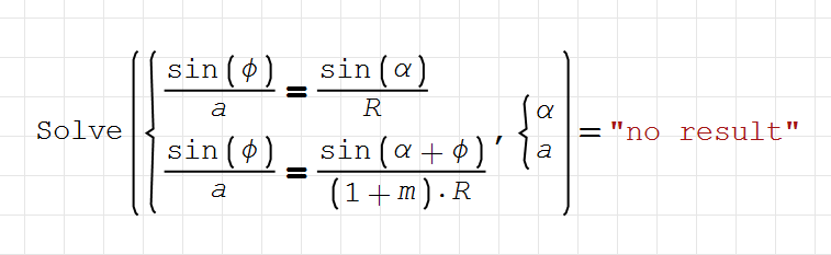

Thanks Jean,
Buy you 2nd sybolic solution is the same as the 1st one.
The solution should not include the unknow a and alpha

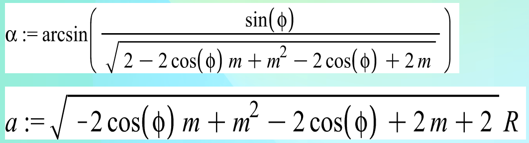

My friend use Maple to get symbolic solution like this
You can see that in the solution of alpha, there is no a, in the solution of a, there is no alpha.

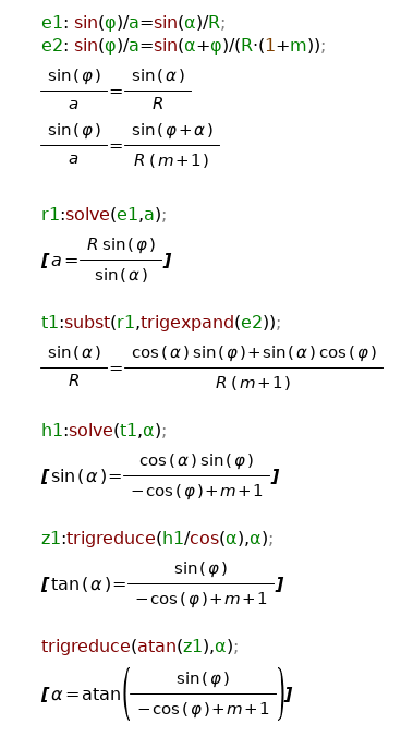

Symbolic solver of maxima is not that capable.
As far as I know of course, maybe there is a simpler way.
But this statement was what I had read about it.
You have to use some substitutions for that solutions.
And some extra division, arc functions, visa versa.
Here is α solved symbolically in wxMaxima.
Same method can be applicable for variable a.
untitled.wxmx.zip (1,6 КиБ) скачан 392 раз(а).

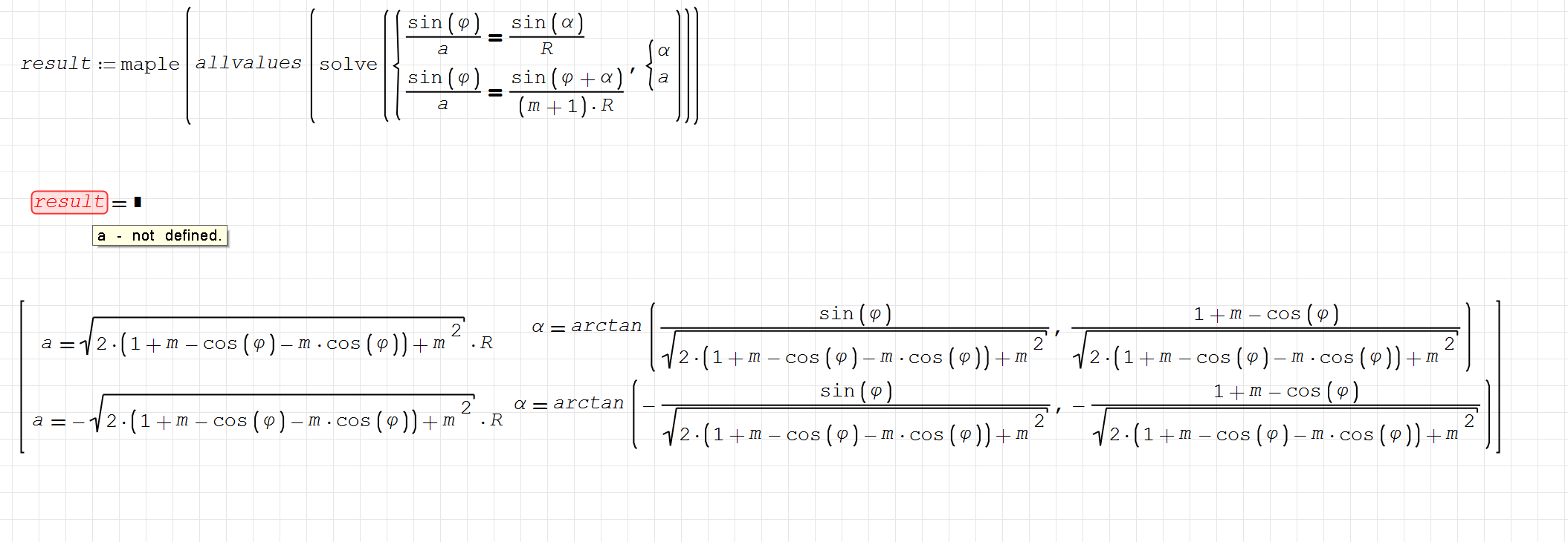

Is Maple plugin in Smath able to get symbolic results as Maxima does, but more easily?
#7 Опубликовано: 22.02.2022 11:55:34
Maple is easier to use, that is a fact.
And sometimes it gives better results.
But Maxima can surpass Maple at certain aspects.
Use what suits your needs most.
In the example below, I solved your function with Maple.
Though it gives the results correct, result matrix is cripled.
Copying and changing last bits of result ";2;1)" to ";2;2)" will correct the result.
";" may differ to "," according to your arguments separator.
Worksheet1.sm (15,97 КиБ) скачан 1320 раз(а).
Hi overload,
When I open you sm I get this error
appears in red, because the evaluation must be symbolic.
select the "result" variable, press the right button and in the type of evaluation select symbolic and that's it.
I hope I have served you, greetings

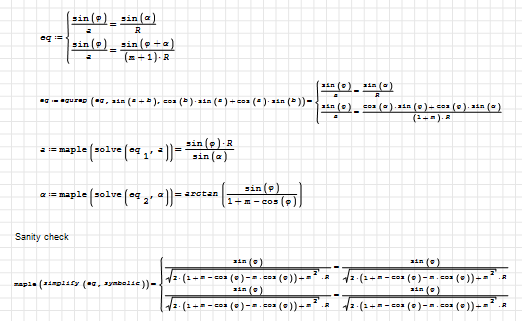

#11 Опубликовано: 16.04.2022 12:43:00
Hi. Another way, applying trigonometric identities.
solve_trig.sm (12,03 КиБ) скачан 1266 раз(а).
Addition to churichuro's reply, use this simple function to correct maple plugin result matrices.
maplecorrect.sm (26,79 КиБ) скачан 1885 раз(а).
