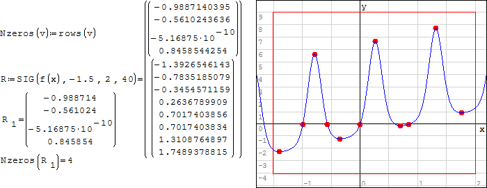

Non iterative methods for root estimation + iterative methods based on the sign(1) function for finding roots and maximum/minimum values in a range.
Signum-based Iterative methods.sm (185.41 KiB) downloaded 1386 time(s).
2016-05-16 17_40_31-SMath Studio Desktop - [Signum-based Iterative methods.sm].png
frapuano 2016/5/16 14:51:00, Andrey Ivashov 2016/5/17 10:36:00

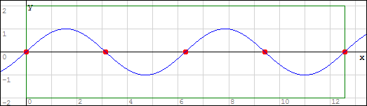

Thanks Davide ... that will make my day !
I discovered the "GID" transit integrator in Mathcad 11.
Works as well in Smath. Don't know if other CAS support ?
Then: like this

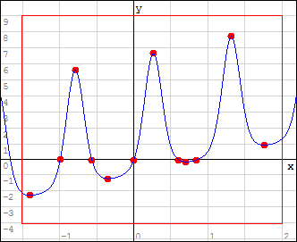

... in your last example: there is a missing 0 and an extra min/max
Davide Carpi 2016/5/16 12:42:00
#6 Posted: 2016/5/16 12:47:09
1,443 likes in 2,935 posts.
True, thank you Jean
Usually it may need to play a little with bounds and intervals. In this case changing intervals from 40 to 41 fixed the issue. (updated the first post)
