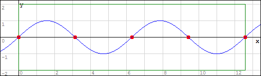

Non iterative methods for root estimation + iterative methods based on the sign(1) function for finding roots and maximum/minimum values in a range.
Signum-based Iterative methods.sm (185,41 КиБ) скачан 1467 раз(а).

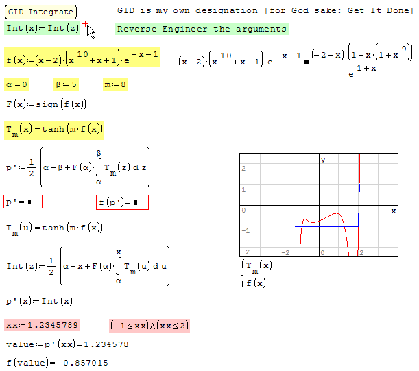

Thanks Davide ... that will make my day !
I discovered the "GID" transit integrator in Mathcad 11.
Works as well in Smath. Don't know if other CAS support ?
Then: like this
#3 Опубликовано: 16.05.2016 09:48:38
BTW: Nobody @ PTC Mathcad Community has seen "GID" integrator,
PTC and Jean ended "warflame" years ago before "GID" [just too bad].
#4 Опубликовано: 16.05.2016 10:12:07
... p'(x) takes a while to plot.
Integrate GID Signum.sm (15,22 КиБ) скачан 1412 раз(а).

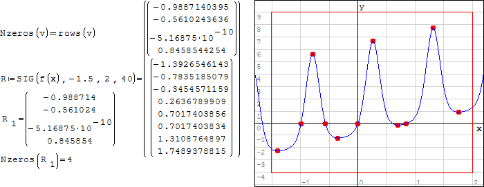

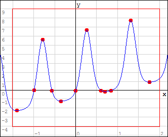

#5 Опубликовано: 16.05.2016 10:48:25
... in your last example: there is a missing 0 and an extra min/max
Davide Carpi 16.05.2016 12:42:00
#6 Опубликовано: 16.05.2016 12:47:09
True, thank you Jean
Usually it may need to play a little with bounds and intervals. In this case changing intervals from 40 to 41 fixed the issue. (updated the first post)
