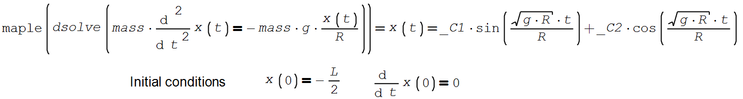

#4 Posted: 2023/7/1 10:51:35
Valery Ochkov
Valery Ochkov
66 likes in 690 posts.
Thanks!
But no way to do so in SMath
"L & m" are missing in dsolve result ?
m is missing in dsolve.

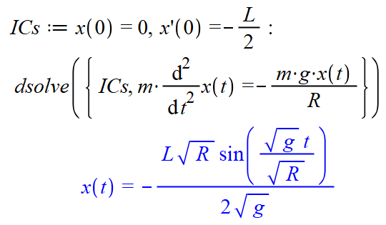

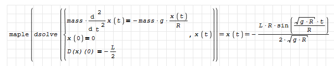

#5 Posted: 2023/7/1 14:48:44
1,123 likes in 1,795 posts.
See please one ODE symbolic solution without IC
Hi Valery. Use Ctrl+Shift+K for write D(x)(0), which means x'(0)
Valery Ochkov 2023/7/2 04:05:00
#6 Posted: 2023/7/2 04:06:01
Valery Ochkov
Valery Ochkov
Thanks!
dsolve-ICs.sm (10.61 KiB) downloaded 1316 time(s).

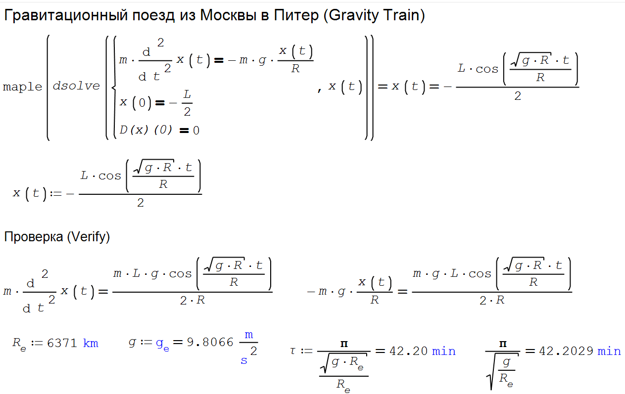

#7 Posted: 2023/7/3 03:43:12
The distance between the cities added.
GravityTrain.sm (31.01 KiB) downloaded 1247 time(s).
GravityTrain.pdf (233.1 KiB) downloaded 772 time(s).

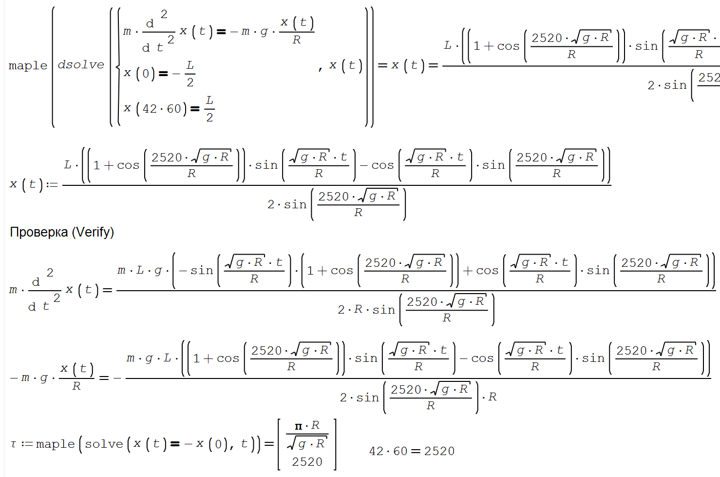

#9 Posted: 2023/7/4 02:14:47
Valery Ochkov
Valery Ochkov
The Boundary problem?
dsolve-Boundary.sm (17.01 KiB) downloaded 1287 time(s).

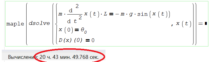

#10 Posted: 2023/7/4 09:30:11
Valery Ochkov
Valery Ochkov
A pendulum
#11 Posted: 2023/7/4 18:53:08
A pendulum ...
The exact solution needs some handwrite work.
Edited: a hard handwrite work. Previous version was wrong.
Click to enlarge
Correct solution -> pendulum v2.sm (13.73 KiB) downloaded 1277 time(s).
Wrong solution -> pendulum.sm (13.88 KiB) downloaded 1274 time(s).
Valery Ochkov 2023/7/5 06:23:00
