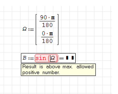

Hi guys (and girls of course if any)
can someone help me with the following error message and what is wrong here:
Thanks!
#2 Posted: 2021/5/5 21:29:38
churichuro
churichuro
29 likes in 79 posts.
this does the trick!
Bruno Choquepata 2021/5/6 00:38:00

However, to have a correct representation you must use a smaller time step. The period is equal to 0.04 sec -> use at least 0.001 sec
#6 Posted: 2021/5/6 14:08:37
dimart17@mainl.ru
dimart17@mainl.ru
0 likes in 4 posts.
Thanks a lot mate! This really does the trick!

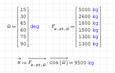

#8 Posted: 2021/5/6 19:47:25
dimart17@mainl.ru
dimart17@mainl.ru
0 likes in 4 posts.
Now I need to multiply two arrays of values and get a third array of values. This is very easy. For some reason I get just one figure instead of array. What is wrong here and how to solve this?

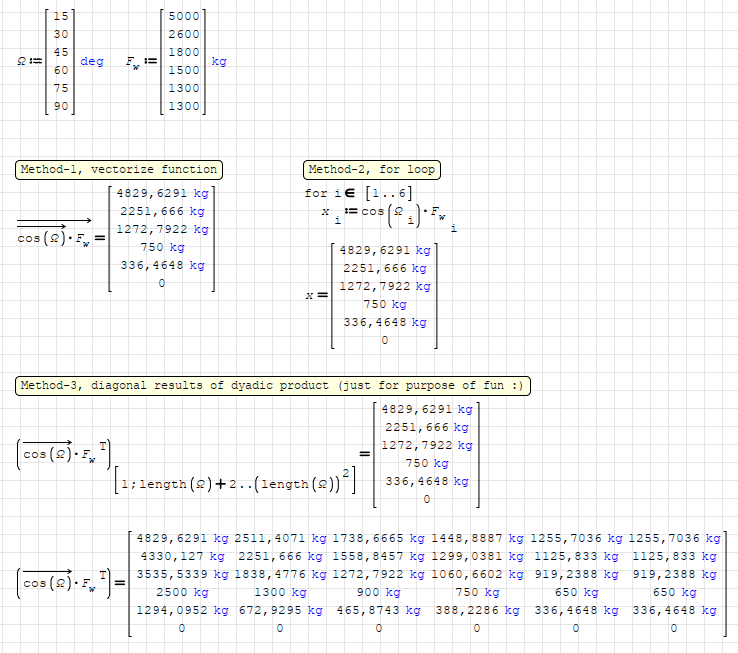

Thanks a lot, buddy! Much appreciated! This program is really good but needs some good help section for beginners like myself
#11 Posted: 2021/5/6 20:28:20
598 likes in 1,380 posts.
There are different methods you can use.
You either multiply with vectorize function. Sometimes this function will not avail.
Or multiply the elements piece by piece with for loop, in some cases this is the only way.
Or calculate dyadic product and take the transverse results of it. Why? because you can (swh).
