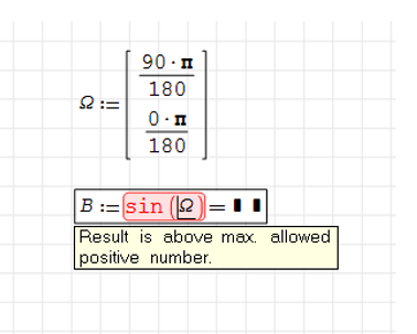

Hi guys (and girls of course if any)
can someone help me with the following error message and what is wrong here:

#2 Posted: 5/5/2021 9:29:38 PM
churichuro
churichuro
29 likes in 79 posts.
this does the trick!

#6 Posted: 5/6/2021 2:08:37 PM
dimart17@mainl.ru
dimart17@mainl.ru
0 likes in 4 posts.
Thanks a lot mate! This really does the trick!

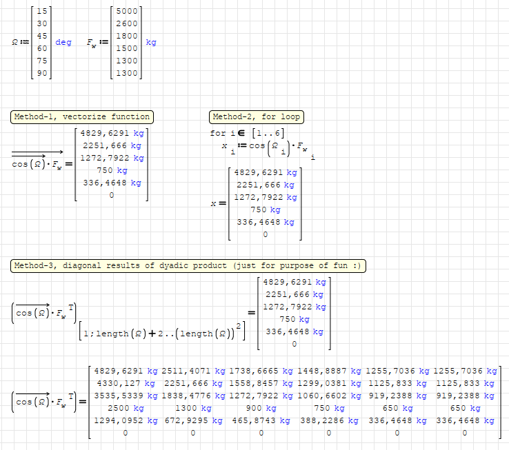

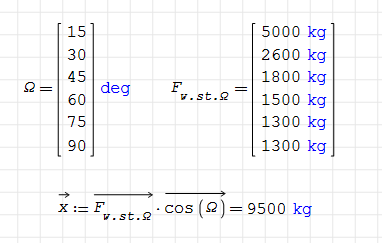

Now I need to multiply two arrays of values and get a third array of values. This is very easy. For some reason I get just one figure instead of array. What is wrong here and how to solve this?

#11 Posted: 5/6/2021 8:28:20 PM
600 likes in 1,381 posts.
There are different methods you can use.
You either multiply with vectorize function. Sometimes this function will not avail.
Or multiply the elements piece by piece with for loop, in some cases this is the only way.
Or calculate dyadic product and take the transverse results of it. Why? because you can (swh).
