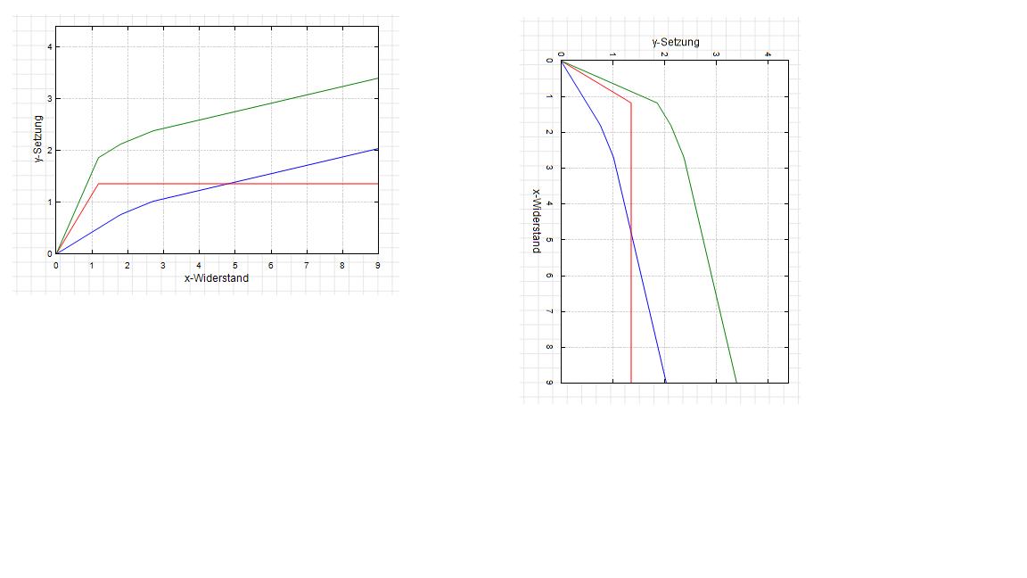

1. is it possible to rotate the graph or function? I wanna switch x and y axis

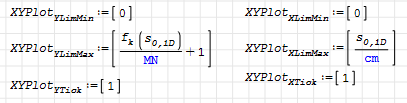

2. i wanna make the visible spectrum of x and y axis depent on a variable. like X-Axis Max=s1 and Min=s2
//sorry for my bad english

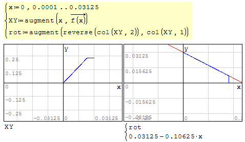

... once the discrete data set in hand,
you can rotate by any angle as desired.

2. I wanna make the visible spectrum of x and y axis depend on a variable. like X-Axis Max=s1 and Min=s2
If I understand: once the discrete data set in hand,
very easy to range between Mi/Max.
Produce the discrete data set, I will terminate.
Cheers ... Jean.

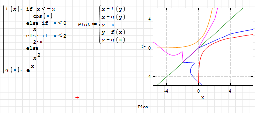

1. Yes. For example you can use this technique over your functions
xy-yx-plot.sm (7.16 KiB) downloaded 1167 time(s).
2. Yes. For example you can try to learn about how to use setprop in an XY plot region.

question 2: solved after find this
https://en.smath.com/forum/yaf_postsm57205_X-Y-Plot-Region.aspx
but to rotate the graph like this it didnt work. i tried your suggestions. Pfahlsetzungslinie1.sm (80.01 KiB) downloaded 1193 time(s).

Hi. You need to specify the XYPlot index. This is how to swap axis coordinates, and reverse the y-axis. I reduce the number of points in the XYPlot to 50.
Pfahlsetzungslinie1.sm (87.42 KiB) downloaded 1208 time(s).

But to rotate the graph like this it didn't work.
I tried your suggestions.
You haven't produced the discrete data set.
Cheers ... Jean.
Wanna Rotate.sm (14.34 KiB) downloaded 1146 time(s).

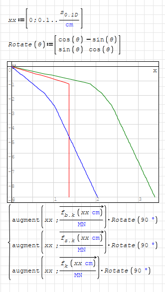

You can also use a rotation matrix.
It works on both 2DPlot an XYplot.
churichuro 2023/2/13 16:11:00
#14 Posted: 2023/2/13 10:41:33
Rotate XY.sm (486.01 KiB) downloaded 1189 time(s).
