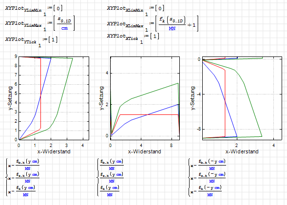

Hey guys,
im trying to plot my function with x-yplot (addon) but it doesnt work. I will be happy if can someone can help me.

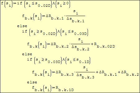

i define two functions (with If-clauses) and now I have to put it in x-y-plot.
Thanks for helping
Pfahlsetzungslinie.sm (101,89 КиБ) скачан 1268 раз(а).

I define two functions (with If-clauses) and now I have to put it in x-y-plot.
1. Start by the first red instance ... assign the demand.
2. For the plot Units don't match
3. Check if your incomplete Bolean is OK ... here shown complete.

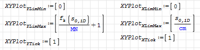

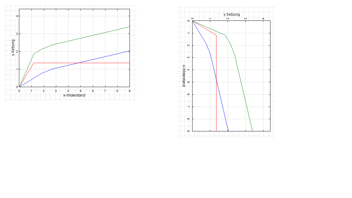

1. is it possible to rotate the graph or function? I wanna switch x and y axis
2. i wanna make the visible spectrum of x and y axis depent on a variable. like X-Axis Max=s1 and Min=s2

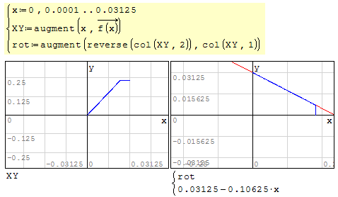

#6 Опубликовано: 11.02.2023 16:46:06
... once the discrete data set in hand,
you can rotate by any angle as desired.

2. I wanna make the visible spectrum of x and y axis depend on a variable. like X-Axis Max=s1 and Min=s2
If I understand: once the discrete data set in hand,
very easy to range between Mi/Max.
Produce the discrete data set, I will terminate.
Cheers ... Jean.
#8 Опубликовано: 12.02.2023 01:43:27
1 125 сообщений из 1 798 понравились пользователям.
... i have 2 more question.
Hi Beyaz.
1. Yes. For example you can use this technique over your functions
xy-yx-plot.sm (7,16 КиБ) скачан 1241 раз(а).
2. Yes. For example you can try to learn about how to use setprop in an XY plot region.

question 2: solved after find this
https://en.smath.com/forum/yaf_postsm57205_X-Y-Plot-Region.aspx
but to rotate the graph like this it didnt work. i tried your suggestions. Pfahlsetzungslinie1.sm (80,01 КиБ) скачан 1264 раз(а).
#10 Опубликовано: 12.02.2023 08:47:18
Hi. You need to specify the XYPlot index. This is how to swap axis coordinates, and reverse the y-axis. I reduce the number of points in the XYPlot to 50.
Pfahlsetzungslinie1.sm (87,42 КиБ) скачан 1282 раз(а).

But to rotate the graph like this it didn't work.
I tried your suggestions.
You haven't produced the discrete data set.
Cheers ... Jean.
Wanna Rotate.sm (14,34 КиБ) скачан 1226 раз(а).

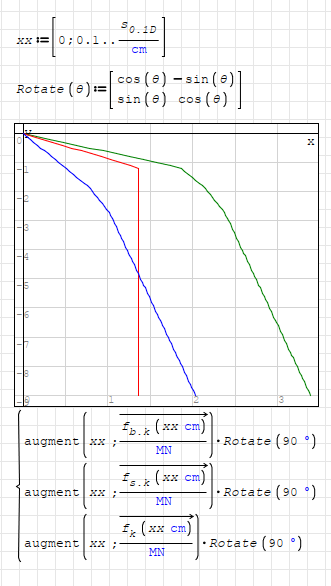

You can also use a rotation matrix.
It works on both 2DPlot an XYplot.
churichuro 13.02.2023 16:11:00
#14 Опубликовано: 13.02.2023 10:41:33
Rotate XY.sm (486,01 КиБ) скачан 1269 раз(а).
