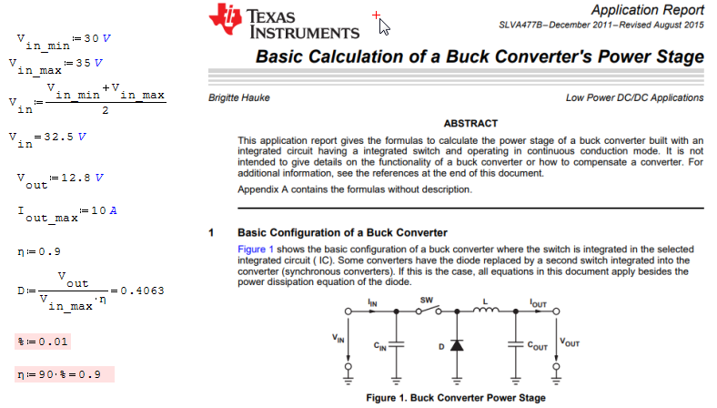

The attached sMath file is an attempt to add "current page" background images. One image per page. It work find for the first two pages, but the third one get skipped and the image appeared on the fourth page.
dc dc buck converter.sm (735.13 KiB) downloaded 751 time(s).
Basic Calculation of a Buck Converter Power Stage.pdf (202.96 KiB) downloaded 471 time(s).
The goal here is to study technical document by overlaying sMath formula, graph and other elements on top of the background images.
Also attached, the original PDF file and the png images for each pages.
Also, it is not obvious how to remove background images, either "All" or "Current page". I couldn't remove the ones in the attached sMath file.
Thank you for your help
Guy

Oups, I didn't know that the images would appear full size. I am sorry, but I dont know how to to it otherwise.
I did not know that several background images can be inserted. Actually, I do not know how to do it either. But as workaround you can edit the sm file for correct the position of the image on page 3.

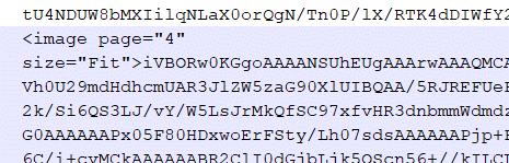

As for how to do it, just select "Background..." in the "Insert" menu. You will see the background setting window.
As I mention in the post, part of that UI is not obvious. It is hard to tell if you have already selected a "Current page" background. Also the default setting seem to reset itself each time you quit the window. The expected behavior would be to reflect the setting of the current page or the whole document.
Editing the file worked first try. That is great :-) The sm format is pretty simple, nice to see that.

Hello, I have done a quick test with 5 pages (inserting 5 different background images), and the issue I had is fixed.

Wow this is a fresh take on checking a calculation book or annotating a paper:
if we could import PDF into SMath as background images (PDF plugin update?), one could just overlay SMath calcs onto existing PDF and the print it to PDF.
Alternatively one could come up with a vb code for script region to do creating a .sm file with all backgrounds in it
Yes Alex, you pick up the spirit :-)
I do many scientific review each years, and having the article in the background could be a wonderful feature that increase productivity. One could study articles, course notes, any PDF documents overlapping or replicating various variables, functions, tables, graphs, etc. and trying different inputs and having the effect of that in real time.

Wroteif we could import PDF into SMath as background images (PDF plugin update?), one could just overlay SMath calcs onto existing PDF and the print it to PDF.
Done. Please install updated plug-in using Extensions Manager.
WroteWroteif we could import PDF into SMath as background images (PDF plugin update?), one could just overlay SMath calcs onto existing PDF and the print it to PDF.
Andrey, this tweak just added a whole new horizon of uses of SMath for me, thank you!!!!!
Fresh example of use to annotate with image region (this is neat!)
Wonderful addition to SMath !!!
I did some tests:
1- SMath 99 (build 6877) and PDF Files Plugin 1.0.684.36970
2- From a new sm file
3- File + Open
4- Selected a 8 pages PDF file
5- The PDF first page appeared as an image in the background as expected. But only one page in the sm document. To see the other PDF pages I need to add sm pages manually.
Thank you very much
