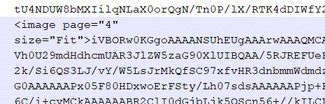

As for how to do it, just select "Background..." in the "Insert" menu. You will see the background setting window.
As I mention in the post, part of that UI is not obvious. It is hard to tell if you have already selected a "Current page" background. Also the default setting seem to reset itself each time you quit the window. The expected behavior would be to reflect the setting of the current page or the whole document.
Editing the file worked first try. That is great :-) The sm format is pretty simple, nice to see that.

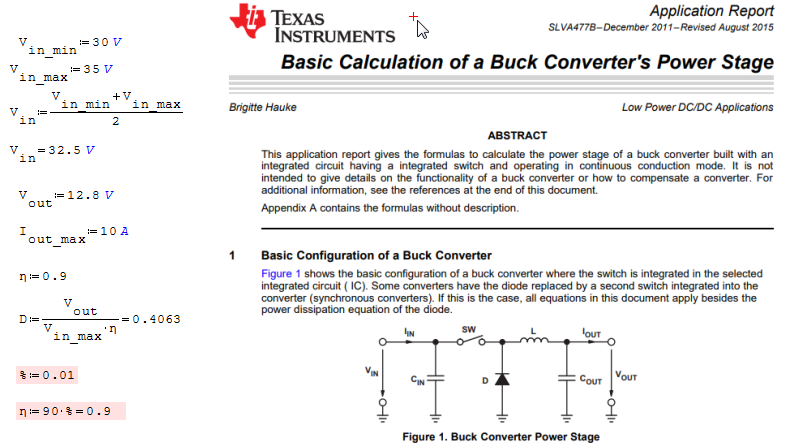

Andrey, this tweak just added a whole new horizon of uses of SMath for me, thank you!!!!!
Fresh example of use to annotate with image region (this is neat!)
Wonderful addition to SMath !!!
