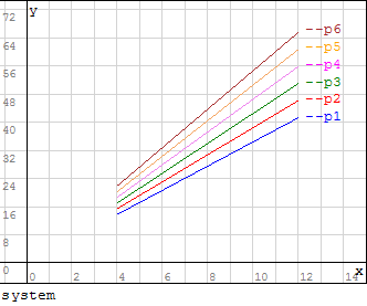

Graphing is NOT my forte ...
Can we plot, quickly, a function that uses two ranges? I cannot find anything in my notes that will help me Heat Capacity.sm (14.56 KiB) downloaded 1008 time(s).
#2 Posted: 2021/1/15 16:38:05
Can we plot, quickly, a function that uses two ranges ?
The 2nd plot is only the XY axes system, as r and t are just multiple.
Maybe, there is a missing link ?
Heat Capacity.sm (22.16 KiB) downloaded 996 time(s).
#3 Posted: 2021/1/15 17:11:14
Fridel Selitsky
Fridel Selitsky
520 likes in 451 posts.
I suggest one of the options
Heat Capacity M.sm (18.26 KiB) downloaded 998 time(s).

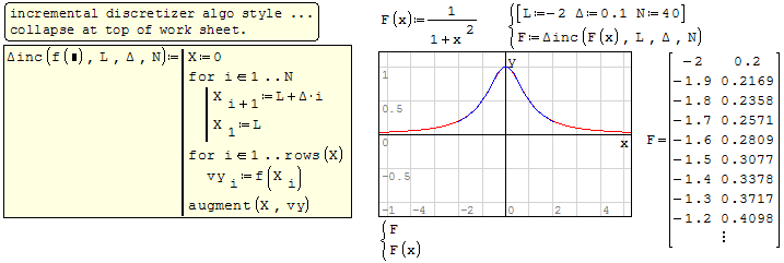

#11 Posted: 2021/1/19 17:01:14
... super discretizer, algo style.
#12 Posted: 2021/1/19 21:08:42

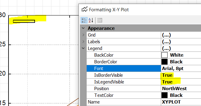

Really helpful. Is there a reason that a legend cannot be created on the plots (X-Y Plot) that are individual colors? I realize you used the built in graph and I updated my snippet sheet with the X-Y PlotCapture.PNG
NEVERMIND ... It'S under TRACES, not LEGEND
#15 Posted: 2021/1/20 18:08:02
Thank you Jean,
X_Y plot does not recognize the multiple linterp, thus plots one trace only.

Ber7 did the 2 var collection in nested vector form,
my last version is table style, much more convivial as I'm used to do.
Units are just a pen in the ass[hole].
A good way is to work units-less, then append silent units.

Thank you guys. I should have just deleted the question when I figured out the legend issue in lieu of answering myself. As mentioned above, it was under TRACES, not LEGEND, in the X-Y Plot
