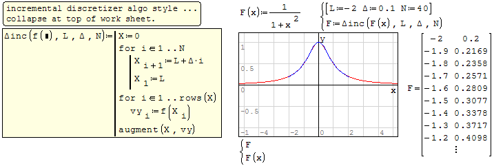

... super discretizer, algo style.

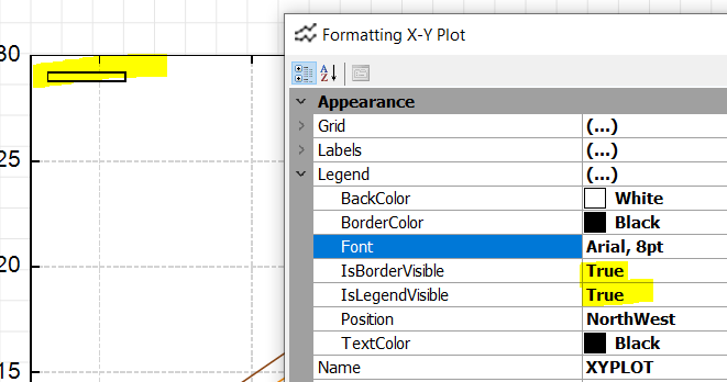

Really helpful. Is there a reason that a legend cannot be created on the plots (X-Y Plot) that are individual colors? I realize you used the built in graph and I updated my snippet sheet with the X-Y PlotCapture.PNG
NEVERMIND ... It'S under TRACES, not LEGEND
X_Y plot does not recognize the multiple linterp, thus plots one trace only.
Alternately, you can add some sort of legend on the QuickPlot.
Page8 Elsid.sm (60.17 KiB) downloaded 1333 time(s).

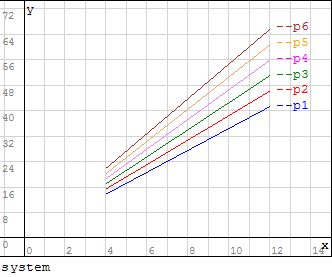

Graph with legend
Ps.sm (7.12 KiB) downloaded 1164 time(s).

Thank you guys. I should have just deleted the question when I figured out the legend issue in lieu of answering myself. As mentioned above, it was under TRACES, not LEGEND, in the X-Y Plot
