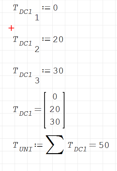

SMath Forum SMath Studio Questions Can I calculate a sum in smath as follows? 1 Pages (2 items) Can I calculate a sum in smath as follows? - Messages Go to last post #1 Posted: 2026/6/24 04:24:31 soomoon 1 likes in 42 posts. Group: User sigma.sm (2.98 KiB) downloaded 176 time(s). #2 Posted: 2026/6/24 07:47:00 sergio 127 likes in 342 posts. Group: User Yes, it's possible. The data needs to be entered in a vector (the first index in SMath is 1, not 0). For example: T.DC1AltGr[1=0 Show Spoiler sergio Edited 2026/6/24 07:49:00 1 users liked this postsoomoon 2026/6/24 09:04:54 1 Pages (2 items) New Posts No New Posts
