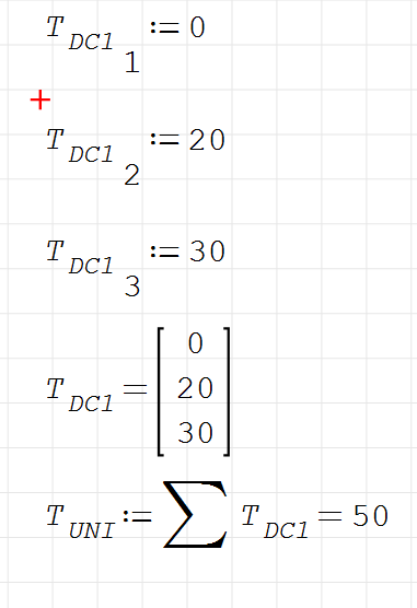

SMath Forum SMath Studio Questions Can I calculate a sum in smath as follows? 1 Pages (2 items) Can I calculate a sum in smath as follows? - Messages Go to last post #1 Posted: 6/24/2026 4:24:31 AM soomoon 1 likes in 42 posts. Group: User sigma.sm (2.98 KiB) downloaded 430 time(s). #2 Posted: 6/24/2026 7:47:00 AM sergio 127 likes in 342 posts. Group: User Yes, it's possible. The data needs to be entered in a vector (the first index in SMath is 1, not 0). For example: T.DC1AltGr[1=0 Show Spoiler sergio Edited 6/24/2026 7:49:00 AM 1 users liked this postsoomoon 6/24/2026 9:04:54 AM 1 Pages (2 items) New Posts No New Posts
