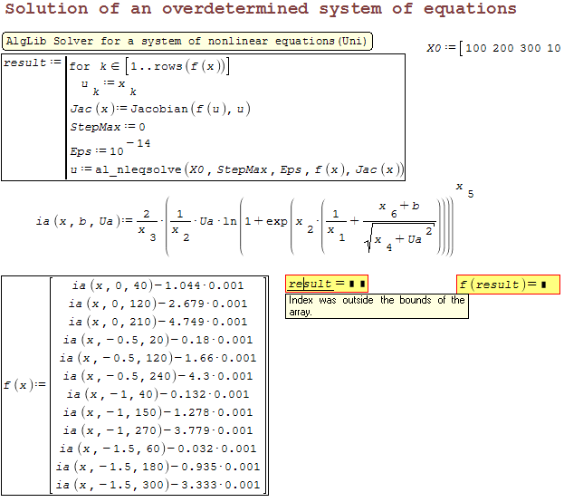

However, AlgLib Solver works faster and depends little on X0 matrix.See # 29
https://en.smath.info/forum/yaf_topics32_Extensions.aspx
Overdetermined.sm (15.26 KiB) downloaded 673 time(s).

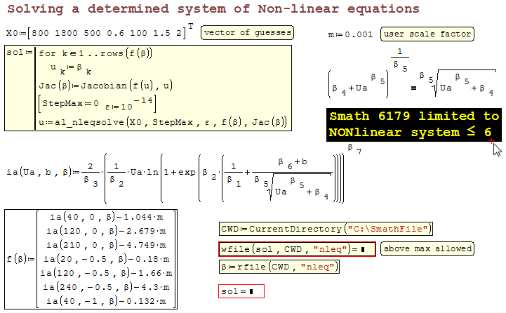

I'm sorry, but again I have problems using this type of algorithm - see the attached image.
#125 Posted: 2018/7/26 17:30:25
Just open and run my latest work sheet, posted today.
If you run 6671, your al_nleqsolve(,,,) needs be updated as well.
"Out of index..." => too many equalities wrt parameters.

Hello.
There are no updates for my 6671. For my SMath directory, I still have errors.
Nicolas
#127 Posted: 2018/7/28 08:07:01

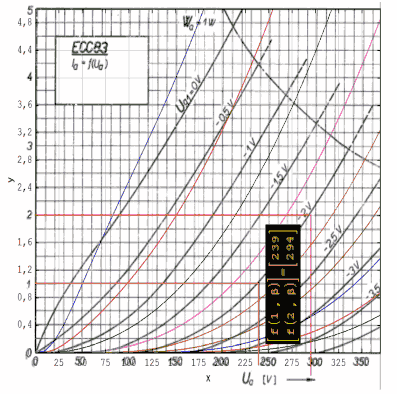

CBG
CBG
78 likes in 312 posts.
I believe that the function:
does not exactly represent the values of the Triode ECC83 graph (Tesla Graph).
Here is a comparison:
Levenberg_Marquardt_Code_CBG_Jean_Tesla_Test.sm (1.45 MiB) downloaded 640 time(s).
Carlos
#132 Posted: 2018/8/2 11:27:15
Quite right, Carlos.
The proposed function fails to fit the data sets.
Tentatively, al_nleqsolve and Levenberg-Marquardt do find a set of parameters.
As applied to fit all curves, then do not fit .
If there is an eventual compatibility, the problem is to initialize.
I tried quite a few with the most robust al_nleqsolve, not to avail.
Of all the models that were tried, I have conserved the 2 constants + 2 parameters
Genfit Minimize Tesla(5) Auto_Iterate
No matter how much maths one can invent, it is not true an invented 6 parameters
will fit 8 data sets each having his own set of 2 parameters. If such miraculous
maths would exist, I bet it would have been explored/exploited in Mathcad/Mathsoft.
Solve al_nleqsolve Ber7_Nicolas Copy.sm (55.14 KiB) downloaded 668 time(s).

You're right Carlos. In fact, this was the first challenge, which was actually missed. Jean Giraud is not right. MatCAD has solved the problem, so mathematical tools exist. Proof is the chart I brought in the first post. Perhaps they will be in SMath in a while too. Until then, I accepted the second challenge, that of studying in detail the current mathematical tools that SMath puts at my disposal. From this point of view, it was a very useful experience. I thank you all for your help.
Nicolas.
#134 Posted: 2018/8/3 16:25:33
OK, Nicolas ... then plot the fitted family of results over the data sets.
Or, attach enough information so that I can spare some times in Mathcad 11.
This is paramount wrt Smath designers, especially from so much efforts.
Cheers Nicolas ... Jean

1. Checked the Mathcad 7 param model is same in Smath
2. if so => run that 7 parameters in attached document.
3. if it solves => attach in forum so it can be tried
Solve al_nleqsolve Ber7_Nicolas [6671].sm (21.11 KiB) downloaded 571 time(s).

The values of beta4 and beta5 strongly depend on vector of guesses
Solve al_nleqsolve Ber7_Nicolas 1.sm (18.72 KiB) downloaded 670 time(s).
#137 Posted: 2018/8/5 19:45:19
The values of beta4 and beta5strongly depend on vector of guesses
The reformated model is now robust.
The native beta's fit exceptionally well the first data set !
Slightly modified for the remaining data sets.
The Mathcad coefficients are given as well for comparing.
Puzzling why the same coefficients produced crappy Mathcad plots ?
All in all, a very interesting project exploiting exp(,) reflexive.
Smath solves decently this 7 parameters project.
Thanks Collabs contributors.
Solve al_nleqsolve Ber7_Nicolas [6179] READ 1rst.sm (73.95 KiB) downloaded 544 time(s).
