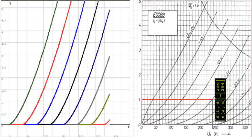

What I did, was simply find the equation that represents each curve
of the given graph. The functions are continuous, but when representing
a polynomial of 4 degree, they are unstable outside the specified ranges.
On the other hand, doing a little research, I found that the curves of
the TESLA graph were constructed with the equations of Scott Reynolds
and Marshall Leachfon, or with the improved equations of Normal L. Koren.

Here is a small attempt to graph the curves with the formulas indicated above.
Tesla_CBG_R1.sm (137.44 KiB) downloaded 983 time(s).

#27 Posted: 2018/6/7 02:43:19
Thank you very much Jean for your accurate response.
Hello Carlos,
I read quick the paper. As it looks, the equation(s) apply to the
circuits with all resistances ... etc.
Some tips to optimize the project.
Nicolas should be happy ... are gone fishing ... how big the fish ?
A most interesting/educative project ... Thanks.
Tesla_CBG_R1 [optimized].sm (262.42 KiB) downloaded 852 time(s).

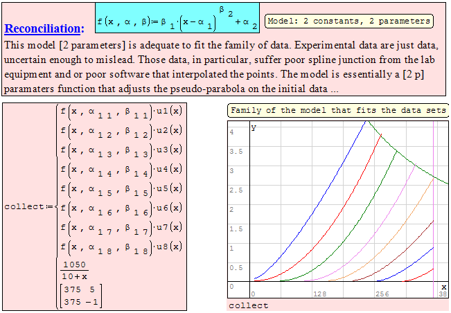

IMHO =
... this model should solve all curves.
It solves/iterates nicely for this particular data set.
f(x,β) recovers from the reduced solving procedure.
Genfit Minimze Tesla.sm (45.6 KiB) downloaded 1023 time(s).

Your complex attempted formulation does not speak to me.
The attached proposal fits your data sets based on 2 parameters and 2 fixed constants.
The constants are the initials X, Y of each experiment. It needs only two parameters
for each experiment. The model function is not suitable for auto-iterate ... peanut
work to calculate trial/error.
If possible, it would be interesting your collect ~ 20 points, raw ... as measured
with good equipment. No processing, no spline curve junction.
Salut Nicolas, will read you soon ... Jean
Genfit Minimize Tesla(5) Copy.sm (207.62 KiB) downloaded 1060 time(s).
#38 Posted: 2018/6/13 21:32:28
... easy to trick the argument (x+ε)
Now, with a single set of initial β it iterates
and fits all data sets !
Genfit Minimize Tesla(5) Auto_Iterate.sm (211.37 KiB) downloaded 1060 time(s).

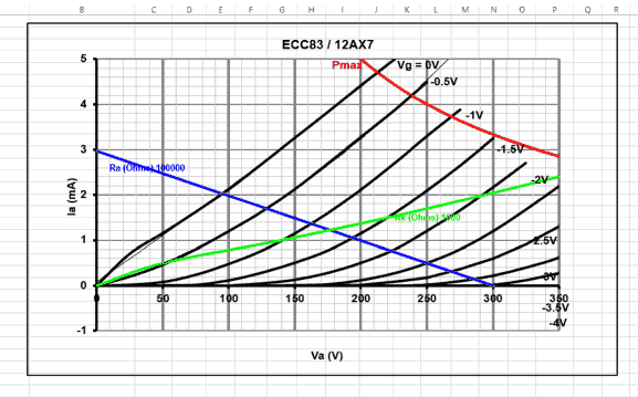

I found this page that I hope will be useful:
http://www.valvewizard.co.uk/links.html
It contains a file in excel for the calculation of the triodes graphs
LoadLinePlotter.xls (817 KiB) downloaded 622 time(s).
