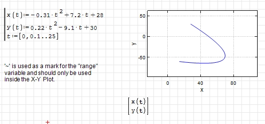

Note that there seems to be a png export glitch. The region t:=25 is disabled in the sheet but not grayed out in the export (image below). The parameter variable obviously must be undefined, otherwise the x and y expressions are just numbers.
para.sm (137.85 KiB) downloaded 727 time(s).
