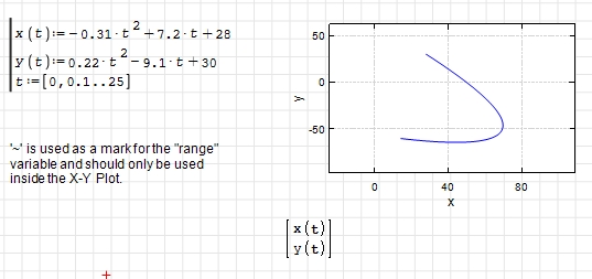

I was looking for a similar topic on the forum, but I couldn't find it.
Is it possible to draw such a graph.
Graphs.sm (4,42 КиБ) скачан 1393 раз(а).
#2 Опубликовано: 17.10.2022 16:16:22
Yes it is possible.
Here is your request.
Graphs_1.sm (4,68 КиБ) скачан 1318 раз(а).

#4 Опубликовано: 18.10.2022 02:53:01
Hi. Just another way, in addition to the solutions offered by Overlord and Pompelmo, using the ability of XYPlot plugin for plot parametric curves, as is explained here.
XYPlot Parametric.sm (5,61 КиБ) скачан 1277 раз(а).
#5 Опубликовано: 18.10.2022 10:08:54
... export your creation
Cheers ... Jean.
Utilities XY plot [Butterfly].sm (29,82 КиБ) скачан 1159 раз(а).

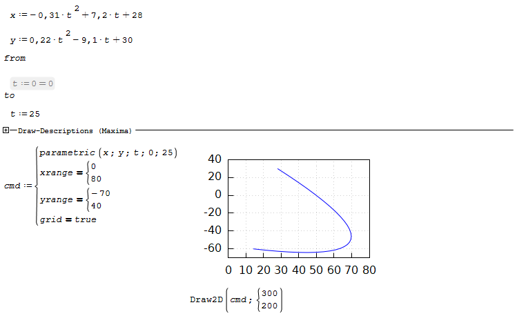

#7 Опубликовано: 19.10.2022 05:17:14
The Maxima plugin provides plotting functions, among them parametric plots. For details look for "kraska smath handbuch".
Note that there seems to be a png export glitch. The region t:=25 is disabled in the sheet but not grayed out in the export (image below). The parameter variable obviously must be undefined, otherwise the x and y expressions are just numbers.
para.sm (137,85 КиБ) скачан 1340 раз(а).
#8 Опубликовано: 20.10.2022 10:00:35
I have no recollection of Parametric Engineering project(s).
Whatever, this document advances your Parametric Journey.
Ultimately, export the project as a standard data table for publishing.
... offered up to the derivatives of the piece-wise project.
Comments, more help ... Welcome.
Cheers ... Jean.
Utilities XY plot Parametric.sm (89,13 КиБ) скачан 1292 раз(а).
