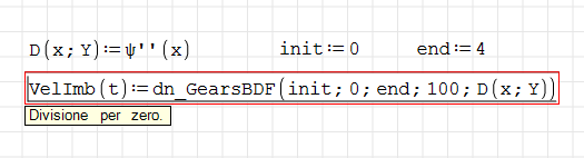

I have a problem with the Smath function "dn_GearsBDF", it blocks the operation since giving me division by zero error.
How can I overcome this problem? MANOVRA (con parametri moto).sm (78.83 KiB) downloaded 1029 time(s).
In dn_GearsBDF(init,0,end,100,D(x,Y)) replace zero with a small positive number (say 10^-10)

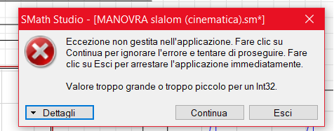

Hi, thanks for the reply.
Instead if I have an error like: "value too big or too small for an Int32", how can I solve it?
Every time this error appears the program stops.
MANOVRA slalom (cinematica).sm (45.07 KiB) downloaded 1106 time(s).

WroteHi, thanks for the reply.
10^10 was probably too small, you have to see, how small x can be for your derivative ψ''(x) still being defined. 0.01 works.
