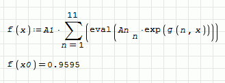

Dear masters,
I'got the error, "Result is above the max. allowed positive number error" during exponential calculation.
How I resolve this kind of errors?
Thank you!

#2 Posted: 2019/8/9 10:09:38
... like this: index 'j' to de-confuse 'i' imaginary.

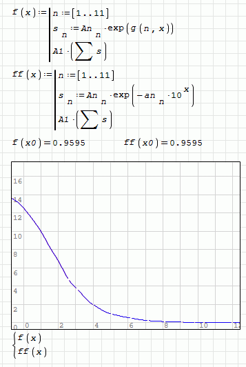

Hi. Summatorie ranged have some issues. For instance, the range variable isn't local. With eval you can get punctual results, but this version can't be plotted, and I don't know why:
Whith this other version you can do both things:
Hope that this helps.

#4 Posted: 2019/8/10 09:08:37
... more doctoring in the *.sm attached
1. local definition mode
2. index piece wise
exponential_max_err_v0 (1).sm (24.22 KiB) downloaded 1015 time(s).

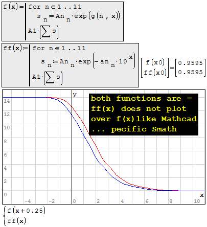

#5 Posted: 2019/8/10 09:39:30
... code this to the previous doctored document.
Summation operator is very capricious, but works
and plot scalar as demonstrated. Plot scalar for
lot more involved stuff [Budapest 39, Legendere ...]
Remember Alvaro: you doctored my Barnes Hypergeometric !

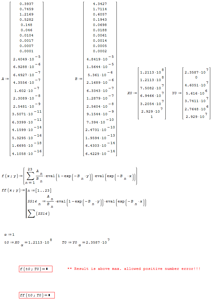

Here are another sample file.
exponential_max_err_v03.sm (18.91 KiB) downloaded 1024 time(s).

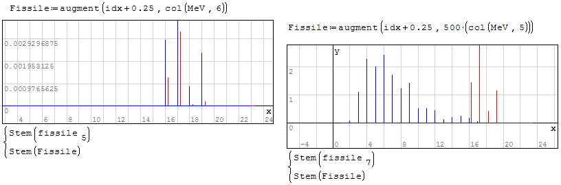

#7 Posted: 2019/8/13 01:08:10
1,123 likes in 1,795 posts.
Hi. Yes, it's hard to drive those calculations. Try to avoid sum(1) too:

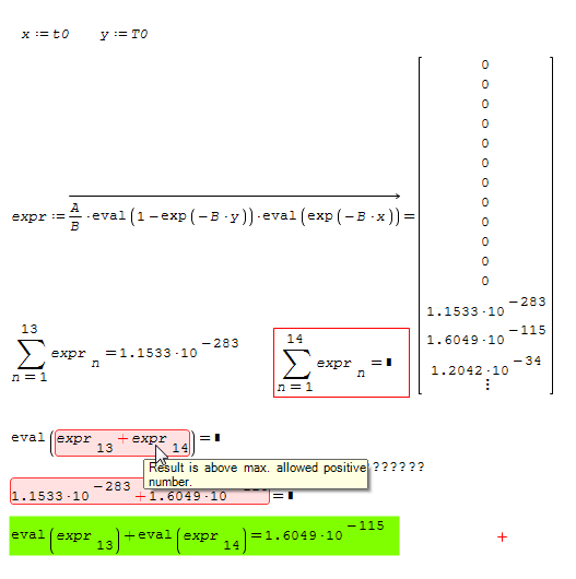

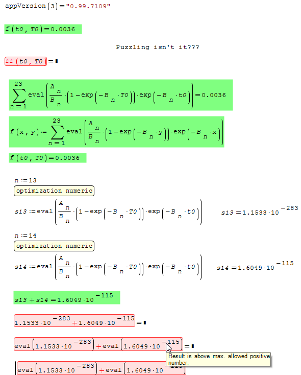

#9 Posted: 2019/8/13 04:35:54
I think something is wrong here in the numeric/symbolic engine of SMath which causes those errors.
Version "0.99.7109"
I can not understand this . The error message is quite confusing. The result is quite a small number close to zero. On the other hand, by mouse hoovering the vector it could be seen the fraction presentation of the numbers (symbolic engine) with quite large numbers in the denominator. Therefore the message about max. allowed positive numbers. I think something is wrong in the floating point arithmetic in SMath numerical engine or at least quite problematic. It seems that eval() must be used extensively in order to escape from these traps and to avoid the symbolic engine to make a mess here.

#11 Posted: 2019/8/13 11:03:24
Version "0.99.7109"
From observation in many more SS 7109, the indexing is freaked.
Doctored in pink SS 6179.
exponential_max_err_v03.sm (17.79 KiB) downloaded 989 time(s).

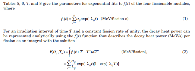

Dear jean,
I'm just doing the calculation of an ANS standard example.
I think this problem is a kind of overflow of exponential function.
As you know if X is greater than the 709.783 then the value of exp(X) is overflown.
So I believe that SMath should do something to check the nominal boundaries of special functions (exponential, logarithmic etc.)
Thank you!
regards,
MS
#13 Posted: 2019/8/13 11:34:52
Thank you!
Thanks for the hint.
Functions that overflow can be managed otherwise.
About that project, just give the X,Y data you want to fit.
Smath reports overflow as "max value ..."
All those math functions aren't Smath, rather from numerical library
as implemented in Microsoft and other maths tools.

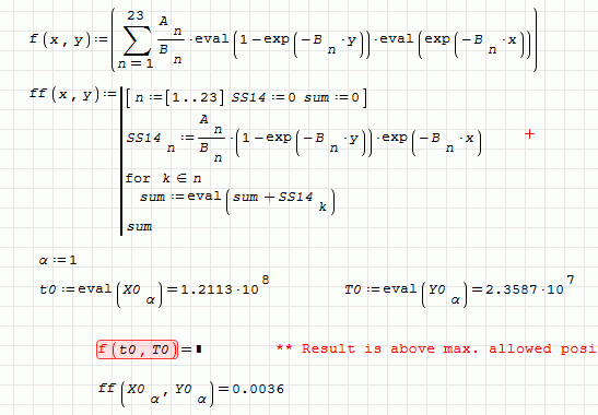

#14 Posted: 2019/8/13 13:08:21
Version "0.99.7109"
Still confused...
exponential_max_err_v03-corr.sm (31.47 KiB) downloaded 1002 time(s).

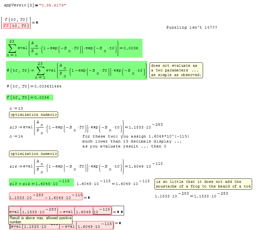

#15 Posted: 2019/8/13 16:19:16
Still confused...
Doctored a bit SS 6179 ... No red in No time.
exponential_max_err_v03-corr.sm (32.81 KiB) downloaded 989 time(s).

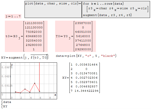

#16 Posted: 2019/8/13 17:03:20
... from there => what's next step ?
exponential_max_err_v03-corr [Next].sm (39.26 KiB) downloaded 865 time(s).
#17 Posted: 2019/8/13 21:27:11
... from there what's next =
... does the suite in green makes sense ?
That mystic formula has to be put in executable maths
exponential_max_err_v03-corr [Next-Suite].sm (160.47 KiB) downloaded 908 time(s).
#18 Posted: 2019/8/14 01:17:41
Please, check my interpretation.
exponential_max_err_v03-corr [Next-Suite].sm (185.37 KiB) downloaded 863 time(s).
#19 Posted: 2019/8/14 03:20:01
Still confused...
Still red for me...
#20 Posted: 2019/8/14 10:04:59
Still red for me...
Radovan, mon ami ... you must feel Sysyphus on that boulder !
I figure the all project is as simple as in the attached SS 6179.
Novice didn't give enough ... wait and see.
On the other hand your red is for Grand Doctor Andrey.
Fission.sm (133.59 KiB) downloaded 966 time(s).
