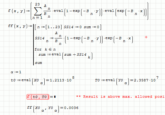

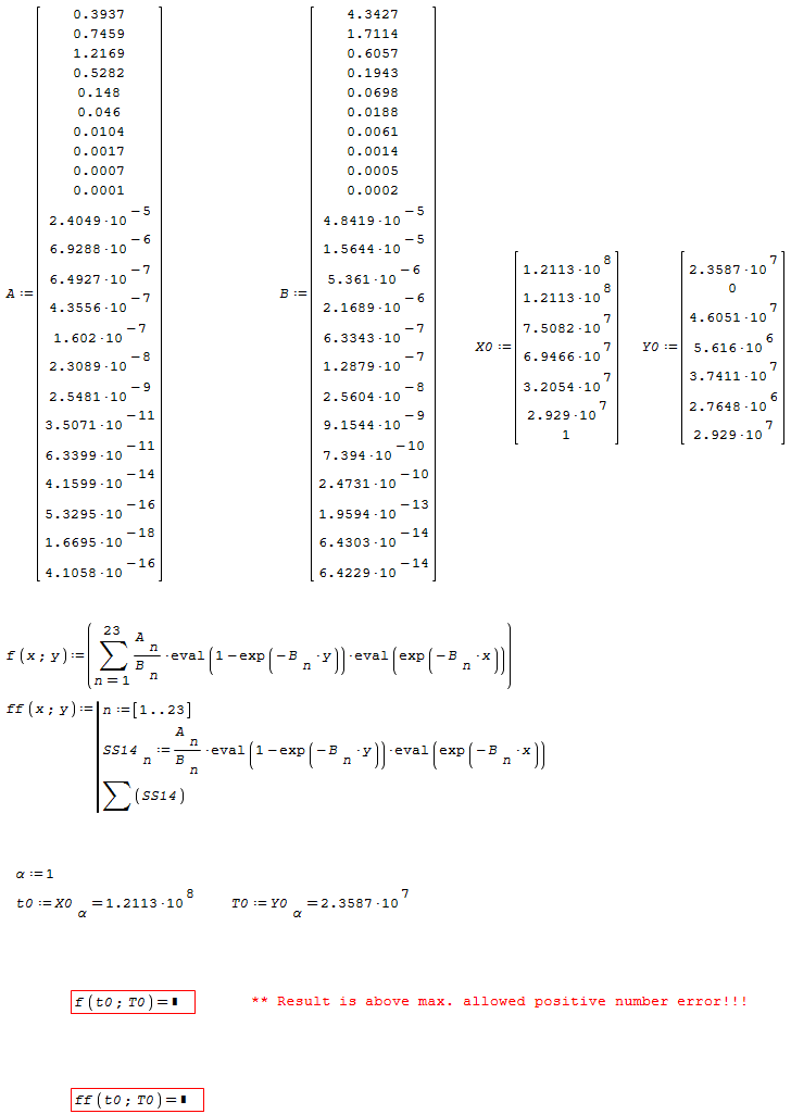

Dear masters,
I'got the error, "Result is above the max. allowed positive number error" during exponential calculation.
How I resolve this kind of errors?
Thank you!
M.S.
my error
exponential_max_err_v0.sm (12,83 КиБ) скачан 1160 раз(а).

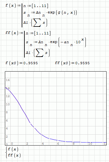

#2 Опубликовано: 09.08.2019 10:09:38
... like this: index 'j' to de-confuse 'i' imaginary.
exponential_max_err_v0.sm (12,26 КиБ) скачан 1151 раз(а).

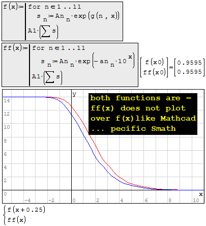

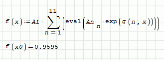

Hi. Summatorie ranged have some issues. For instance, the range variable isn't local. With eval you can get punctual results, but this version can't be plotted, and I don't know why:
Whith this other version you can do both things:
Hope that this helps.
exponential_max_err_v0.sm (13,37 КиБ) скачан 1201 раз(а).

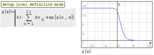

#4 Опубликовано: 10.08.2019 09:08:37
... more doctoring in the *.sm attached
1. local definition mode
2. index piece wise
exponential_max_err_v0 (1).sm (24,22 КиБ) скачан 1177 раз(а).
... code this to the previous doctored document.
Summation operator is very capricious, but works
and plot scalar as demonstrated. Plot scalar for
lot more involved stuff [Budapest 39, Legendere ...]
Remember Alvaro: you doctored my Barnes Hypergeometric !

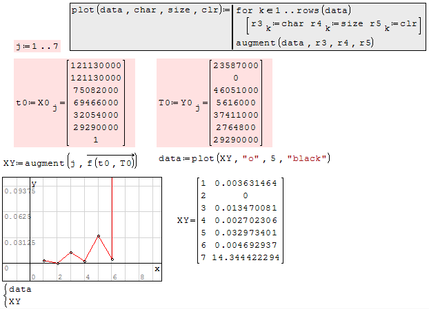

But I have a still same problem.
Here are another sample file.
exponential_max_err_v03.sm (18,91 КиБ) скачан 1182 раз(а).
#7 Опубликовано: 13.08.2019 01:08:10
Hi. Yes, it's hard to drive those calculations. Try to avoid sum(1) too:

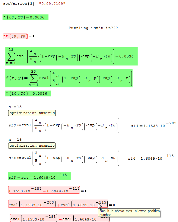

I am getting error "Result is above max allowed positive number",too! And l don't know how to solve it.Function error
#9 Опубликовано: 13.08.2019 04:35:54

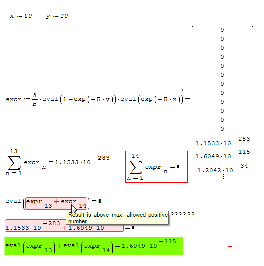

I think something is wrong here in the numeric/symbolic engine of SMath which causes those errors.
Version "0.99.7109"
I can not understand this . The error message is quite confusing. The result is quite a small number close to zero. On the other hand, by mouse hoovering the vector it could be seen the fraction presentation of the numbers (symbolic engine) with quite large numbers in the denominator. Therefore the message about max. allowed positive numbers. I think something is wrong in the floating point arithmetic in SMath numerical engine or at least quite problematic. It seems that eval() must be used extensively in order to escape from these traps and to avoid the symbolic engine to make a mess here.

#11 Опубликовано: 13.08.2019 11:03:24
Version "0.99.7109"
From observation in many more SS 7109, the indexing is freaked.
Doctored in pink SS 6179.
exponential_max_err_v03.sm (17,79 КиБ) скачан 1148 раз(а).

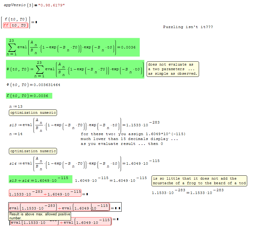

#15 Опубликовано: 13.08.2019 16:19:16
Still confused...
Doctored a bit SS 6179 ... No red in No time.
exponential_max_err_v03-corr.sm (32,81 КиБ) скачан 1163 раз(а).
#16 Опубликовано: 13.08.2019 17:03:20
... from there => what's next step ?
exponential_max_err_v03-corr [Next].sm (39,26 КиБ) скачан 1021 раз(а).

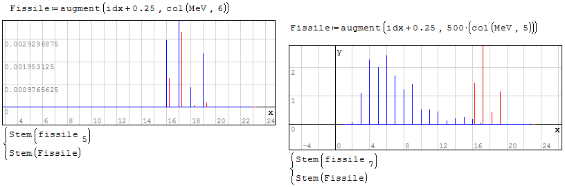

#20 Опубликовано: 14.08.2019 10:04:59
Still red for me...
Radovan, mon ami ... you must feel Sysyphus on that boulder !
I figure the all project is as simple as in the attached SS 6179.
Novice didn't give enough ... wait and see.
On the other hand your red is for Grand Doctor Andrey.
Fission.sm (133,59 КиБ) скачан 1127 раз(а).
