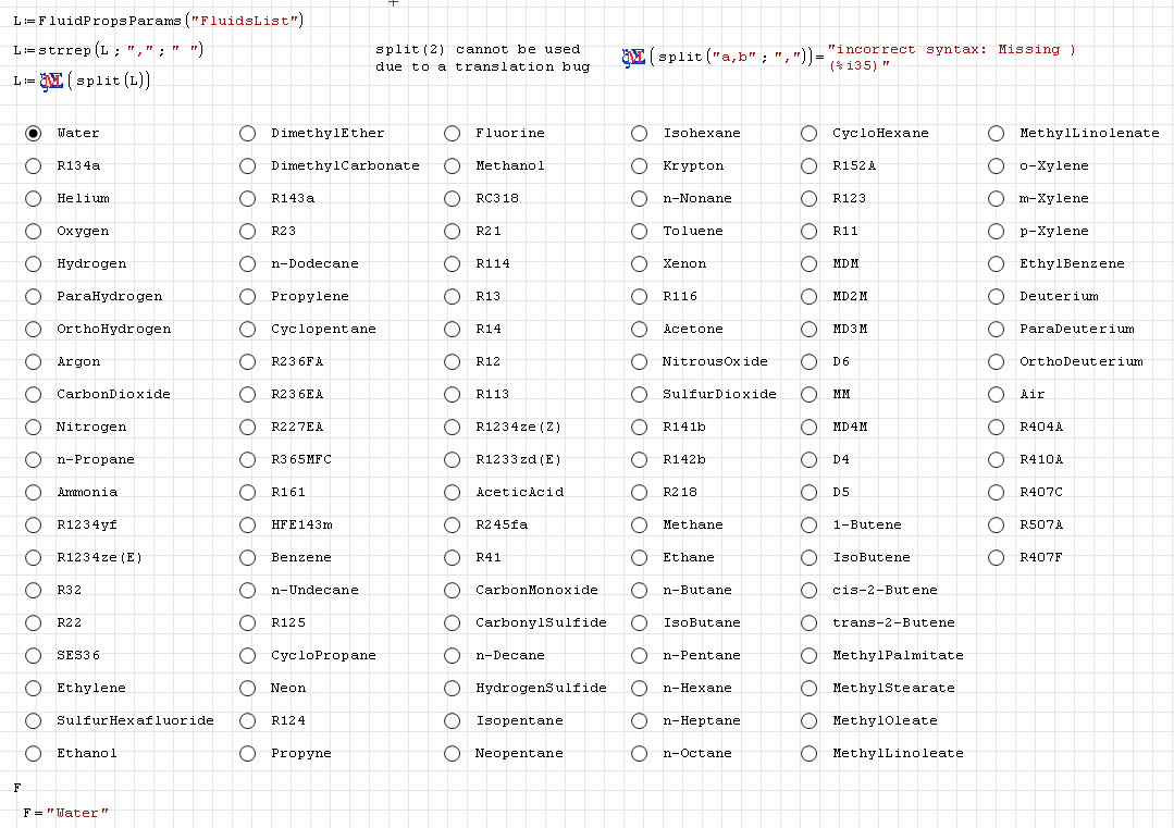

Now the library seems to work. Just strSplit() is undefined.
Maxima has a function split(string, delimiter), however, due to a translation bug only the default delimiter (space) works. Therefore, the kommas have to be replaced by spaces first.
Вячеслав Мезенцев 2014/6/22 04:44:00, Radovan Omorjan 2014/6/22 09:50:00, Tomas Novotny 2025/12/13 20:33:11

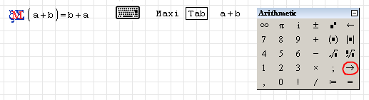

There are some examples in the interactive handbook. Open the handbook via [?] button in the toolbar. Navigate to Mathematics> Symbolic Math with Maxima
If you get a pop-up window "Start Maxima" with a progress bar (not more than 20sec) and no errors in the math regions, then Maxima is running.
A quick test would be to type Maxima TAB a+b and evaluate that symbolically (-> button in the arithmetics palette).
Yet I do not expect Maxima to run, as it has never been tested under Linux in the development. Under linux, Maxima can hardly be run by starting maxima.bat, as done by the plugin. There might be a chance in wine, but I haven't heard of any success.
