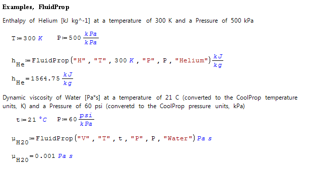

Wrapper of CoolProp for MathCAD 15
copyright Scott Polak and Ian Bell, 2013
To Use
* Copy the CoolPropMathcadWrapper.dll file to C:\\Program Files (x86)\\Mathcad\\Mathcad 15\\userefi or equivalent for your version
* Open the CoolPropFluidProperties.xmcd file in MathCAD, fields should populate
To Use
* Copy the CoolPropMathcadWrapper.dll file to \\userefi or equivalent for your version

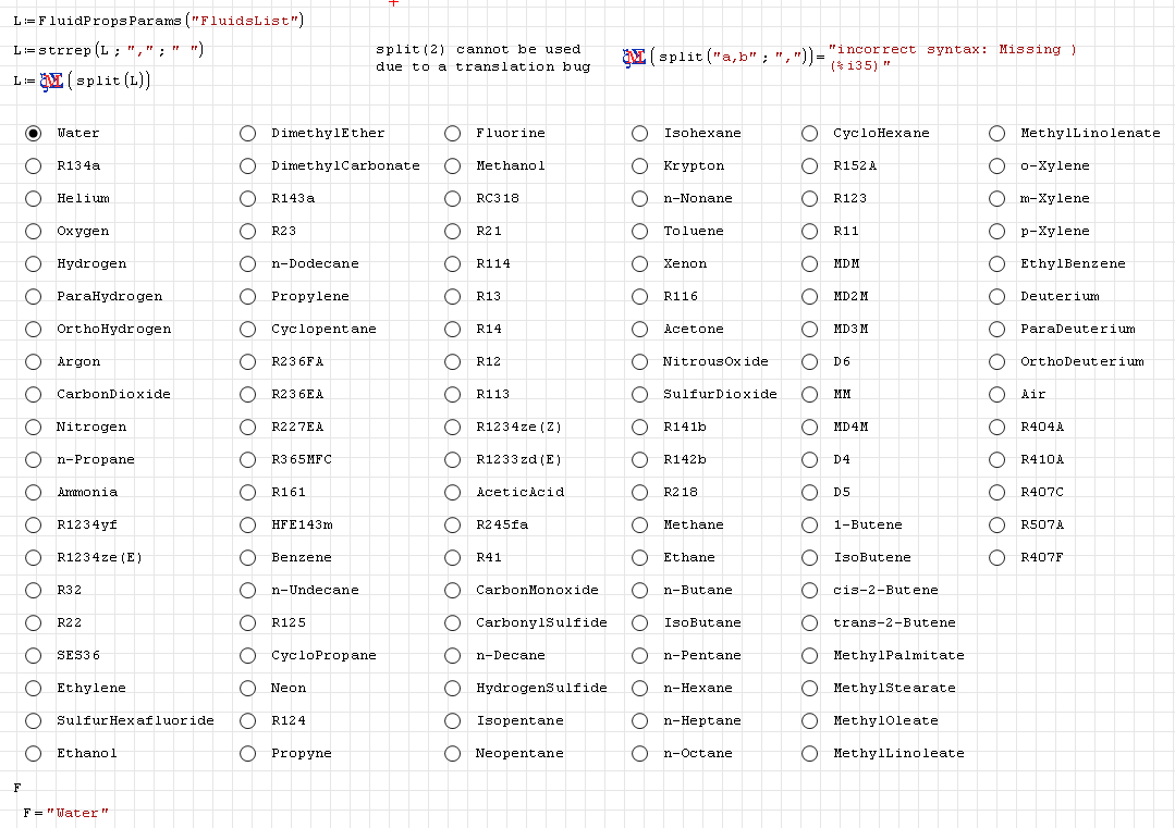

All functions in your example file are undefined.
Thanks for any hint.
I used the wrong dll (from excel and dll subfolder).
Now the library seems to work. Just strSplit() is undefined.
Maxima has a function split(string, delimiter), however, due to a translation bug only the default delimiter (space) works. Therefore, the kommas have to be replaced by spaces first.
Вячеслав Мезенцев 22.06.2014 04:44:00, Radovan Omorjan 22.06.2014 09:50:00, Tomas Novotny 13.12.2025 20:33:11

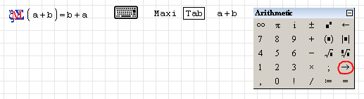

There are some examples in the interactive handbook. Open the handbook via [?] button in the toolbar. Navigate to Mathematics> Symbolic Math with Maxima
If you get a pop-up window "Start Maxima" with a progress bar (not more than 20sec) and no errors in the math regions, then Maxima is running.
A quick test would be to type Maxima TAB a+b and evaluate that symbolically (-> button in the arithmetics palette).
Yet I do not expect Maxima to run, as it has never been tested under Linux in the development. Under linux, Maxima can hardly be run by starting maxima.bat, as done by the plugin. There might be a chance in wine, but I haven't heard of any success.
