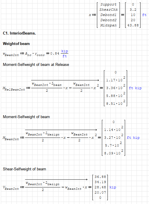

I can not have a right calculation results though I tried to resolve this several times.
When I am using the matrix format, I get the wrong results.
In case that I am using the simple format x=20ft, I get the right result.
Please help me out.

Since x is a matrix and you are using it with other variables, you have to use vectorize.
You can either write it as a function or click to its button on toolbar > matrices.

Here is your file fixed.
