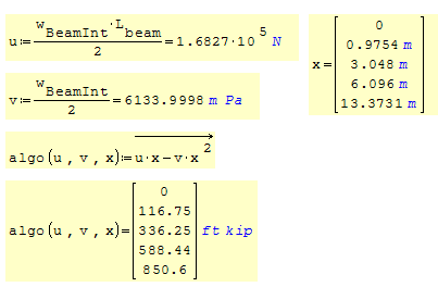

I can not have a right calculation results though I tried to resolve this several times.
When I am using the matrix format, I get the wrong results.
In case that I am using the simple format x=20ft, I get the right result.
Please help me out.
Please help me out.

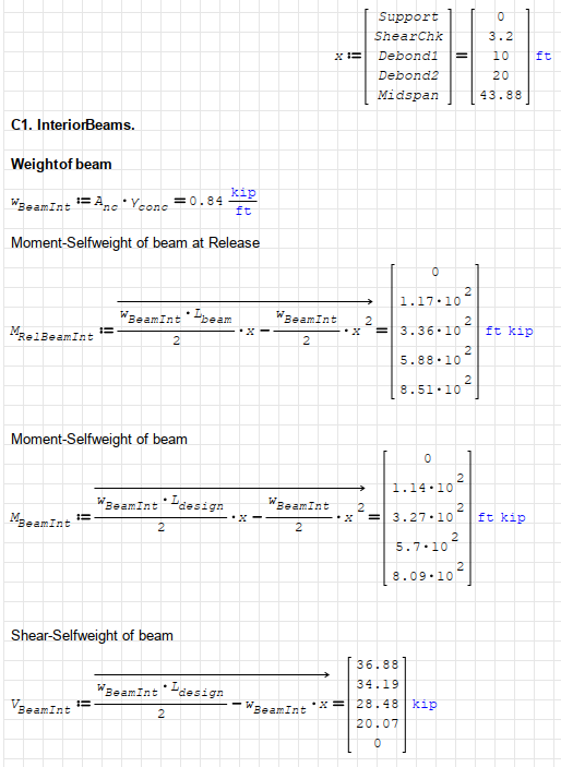

Here is your file fixed.
2 psc beam bridge(US unit)-Dead Load_fixed.sm (188,45 КиБ) скачан 1335 раз(а).
