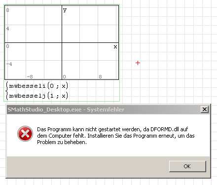

There is an user interaction issue. After updating the plugin and re-starting smath,
the installer dialog pops up and offers installation. You are also informed that you do not need installation if you already have the runtime environment installed. In this case it is natural that the user chooses [Cancel]. Then, however, the dialog pops up every time you launch smath.
If you choose [Install] even if you know that nothing needs to be installed, then suddenly the installer gets aware of that and just finishes and no more messages appear on start-up.
Updated. I think I found a way to do the installation without the use of environment variable path. You can remove the path from the environment variable. Also, you can delete the installation files from c:\MATLAB6p5.

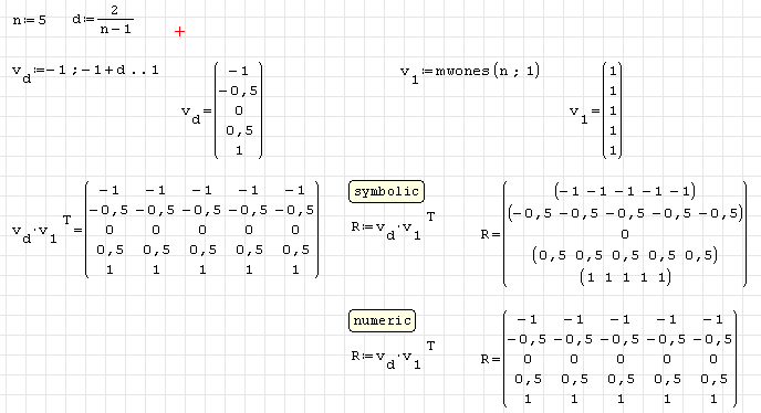

Is there a chance to return scalars if the result matrix has 1x1 size by default (without touching each function separately)? Then we could use all the functions as direct replacement for the standard ones. The drawback would be that these functions cannot handle lists (except if you can recognize that in the plugin and do sys2mat and vice versa.
One could even think of working with any nested structures by flattening them out internally and afterwards restructuring the results according to input.
I guess that unit handling would not be trivial. However, for most special functions this is irrelevant anyways.
WroteWorks here.

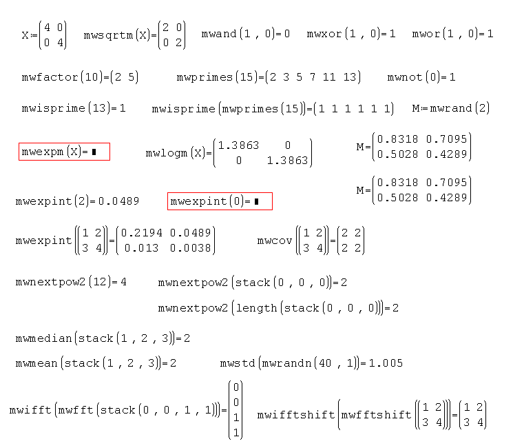

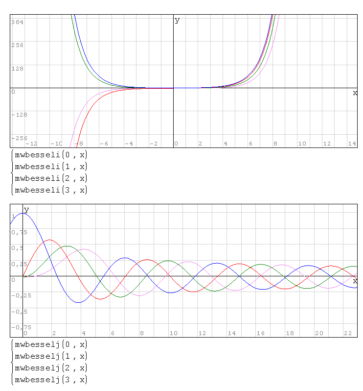

Updated. Done. As for the rest, I'll think about it.
Great! Thanks a lot. Now all functions can be called with scalar argument and return scalars in that case. Is it sensible to include the mw... names in the doc (some of them are already in it) or can they be expected to change to generic ones in the near future?
I'm not sure, but I think that next year we will not see support for namespaces and function overloading. Andrey is a very busy. Therefore, I recommend to use prefixes in the documentation.
For now we have 49 functions.

I confirm the problem. The log in bin/win32 says
25.08.2013 14:18:54 [ERROR] [mwbesseli] Failed to load MEX-File : besselmx.
25.08.2013 14:19:00 [ERROR] [mwbesseli] Failed to load MEX-File : besselmx.
25.08.2013 14:19:09 [ERROR] [mwbesselj] Failed to load MEX-File : besselmx.
25.08.2013 14:19:16 [ERROR] [mwbesselj] Failed to load MEX-File : besselmx.
25.08.2013 14:19:20 [ERROR] [mwbesselj] Failed to load MEX-File : besselmx.
25.08.2013 14:20:55 [ERROR] [mwbesseli] Failed to load MEX-File : besselmx.
and I get an error message from SMath (translated)
The program cannot be launched because DFORMD.dll is missing on your computer. Re-install the program to solve the problem.
such a dll is present on my system as part of the ANSYS finite element package.
Вячеслав Мезенцев 2013/8/25 09:10:00
I checked the log.txt file. There is only one message repeating when I call any of the bessel functions
8/25/2013 2:22:55 PM [ERROR] [mwbesseli] Failed to load MEX-File : besselmx.

Вячеслав Мезенцев 2013/8/25 09:11:00
Updated. Try now. As for mwbetainc(), I don't know yet what's going on.
Radovan Omorjan 2013/8/25 09:20:00
WroteUpdated. Try now. As for mwbetainc(), I don't know yet what's going on.
I can confirm that mwbesselx() functions are working for me

When you assign a matrix generating function to a variable, then this is done symbolically by default in your plugin. Thus, a random matrix looks differently every time it is used. This behaviour is different from Davide's Statistical tools, where numeric evaluation seems to be default.
I guess that symbols with changing contents at every use are somewhat unexpected for the user. Therefore, I would therefore recommend to set evaluation to numeric by default, unless there is something to gain from symbolic evaluation (which I do not see so far, bit I may be wrong).
Edit: There are multiple implications of that SMath symbolics is unaware of scalar or vector properties of operands. Therefore I urgently recommend to suppress symbolic evaluation for (possibly) matrix valued functions. In the second example, replacing mwones() by Ones() solves the problem (mismatch between symbolic and numeric evaluation)
Edit2: To internally apply eval() in every function should help.

some functions do not work...
Error message in log file: Argument to xxx must not be complex.
Error message in SMath: function is not defined.
I can't see any complex argument.
Section math boolean matlab.sm (25.97 KiB) downloaded 1407 time(s).

Updated. 136 functions.
mwrand(), mvrandn(), mwand(), mwor(), mwnot(), mwxor() - bugs fixed;
As for symbolic simplifications when dealing with matrices, I think that in this case it's a bug. The multiplication operator believes that the second operand returns a scalar, but this is not true.
