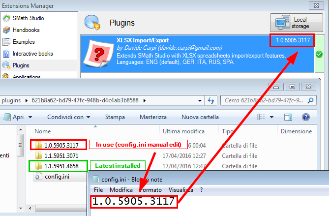

All the downloaded extensions (SS installers, plugins, manuals, etc) are in the %APPDATA%\SMath path. When I say "all", I mean all since you started using SMath, except if you have cleaned this folder or uninstalled the extensions from the Extensions Manager.
Don't confuse SS executables and community's plugins; what was explained by Andrey is about built-in stuff (executables, built-in extensions, registry keys); when the program is updated or uninstalled, community's extensions are kept where they are (%APPDATA%\SMath path). Igor just stated he has reverted the old plugin (you have to edit the config.ini file in the %APPDATA%\SMath\extensions\plugins\{PLUGIN_GUID} path, and setup the version of a previously downloaded plugin, the name of one of the folders contained in that path).
