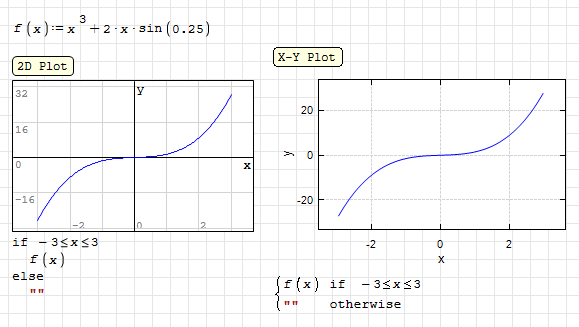

#3 Posted: 2021/10/25 14:35:07
127 likes in 342 posts.
You have defined a vector of values ​​for x. If you use the X-YPLOT plugin you need to change the variable. If instead you use SM native 2D graph then it already works as you expect

Hi, if you need a quick plot I recommend you use 2D standard plot you can plot functions f(x) directly , if you need a more configurable plot use XY plot but you need to put your data in a special format. File not found.File not found.
#7 Posted: 2021/10/25 15:29:09
598 likes in 1,380 posts.
You don't need to use range() and augment() if you want to plot sections.
You can limit it with if-else() or cases().

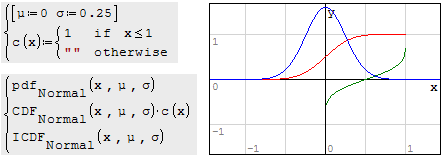

#11 Posted: 2021/10/26 07:05:13
Equation 1 - Normal distribution does not solve as a function until it is vectorized. Why?
1. Discretize the range you want and plot ... No vectorize.
2. Plot scalar directly.
#12 Posted: 2021/10/26 07:29:00

#15 Posted: 2021/10/26 11:29:10
Try this file.
Smath - 2D Plots_r1.sm (17.22 KiB) downloaded 1102 time(s).
