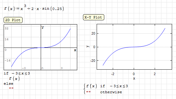

You have defined a vector of values ​​for x. If you use the X-YPLOT plugin you need to change the variable. If instead you use SM native 2D graph then it already works as you expect

Hi, if you need a quick plot I recommend you use 2D standard plot you can plot functions f(x) directly , if you need a more configurable plot use XY plot but you need to put your data in a special format. Файл не найден.Файл не найден.

You don't need to use range() and augment() if you want to plot sections.
You can limit it with if-else() or cases().

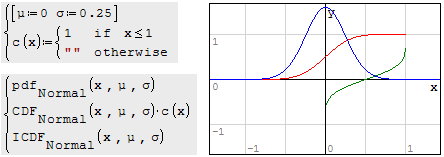

There is about 24 built-in PDF in Smath ... f(x) menu
as well as CDF, ICDF

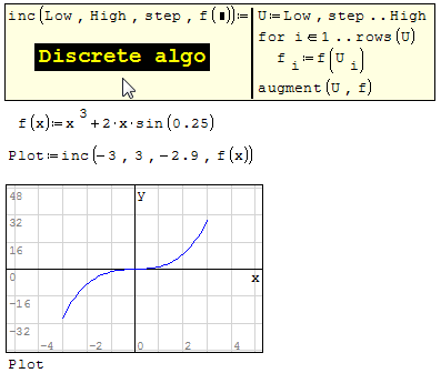

... in most applications inc(Low,High,step,f(#)) is preferred
Paecific.sm (14,25 КиБ) скачан 1261 раз(а).

1. Collapsed the algo at top utilities.
2. Use it infinitely in-situ use [range each f(x) at will].

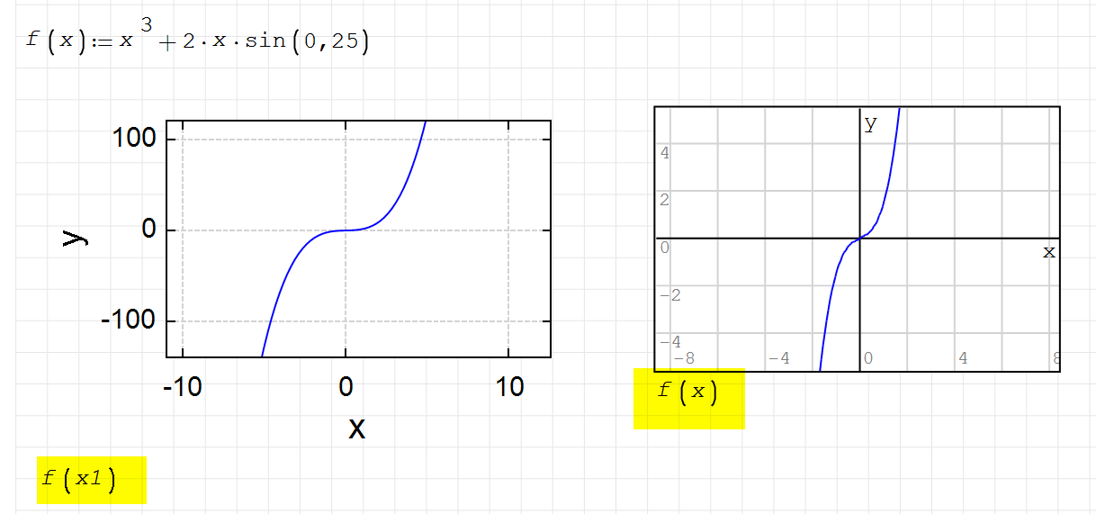

Try this file.
Smath - 2D Plots_r1.sm (17,22 КиБ) скачан 1278 раз(а).
