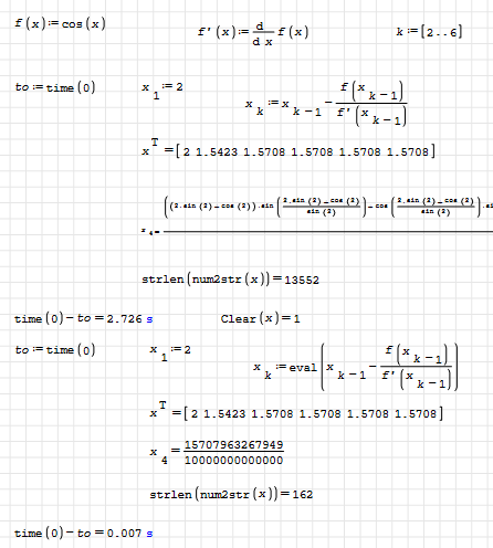

Wrote... When you have loops or complex calculation, the expression terms might stack in a very long equation. If you have a vector or a matrix, each element might contains a lot of them.
When the complexity arise, since an evaluation requires to retrieve each element from the memory, replace it, and perform the actual calculations, it might be useful to perform an eval() ...
Hi. This example can illustrate what Davide says.
using_eval.sm (19.85 KiB) downloaded 1435 time(s).

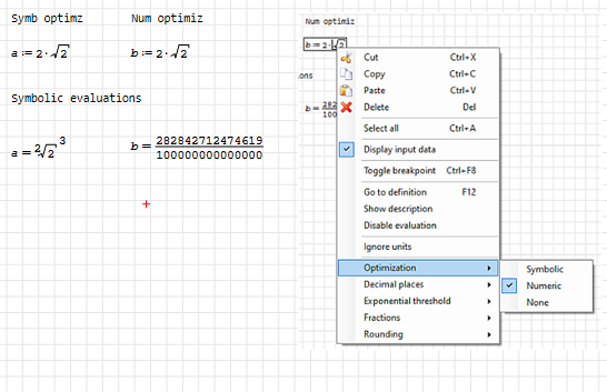

Wrote... think that an 'auto-eval' mode would be a useful feature, but maybe this is not possible to integrate into the Smath structure. ...
Hi. There is something like that, the Optimization/Numeric option from the contextual menu. You can also select all expressions with Ctrl-A and choose that option for the entire worksheet.
num-optimiz.sm (71.39 KiB) downloaded 1423 time(s).
