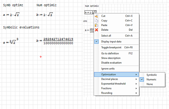

#6 Posted: 5/15/2024 1:37:55 AM
Wrote... think that an 'auto-eval' mode would be a useful feature, but maybe this is not possible to integrate into the Smath structure. ...
Hi. There is something like that, the Optimization/Numeric option from the contextual menu. You can also select all expressions with Ctrl-A and choose that option for the entire worksheet.
num-optimiz.sm (71.39 KiB) downloaded 1631 time(s).
