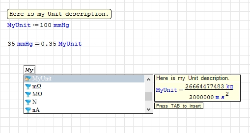

You might use a snippet instead.
These are ordinary SMath files which can be embedded in any other file just by typing their name, usually as collapsed area region. And in ordinary SMath sheets you can define units with descriptions in whatever set of languages.
The advantage is that such files are portable. The disadvantage is that they aren't updated when you update your unit snippet.
This auto-update can be achieved using the plugin-mechanism. It also includes portability, as the dependence on plugin and version is stored in the sm file and any user with an installation lacking this plugin will be offered to download it from the online gallery in the extension manager.

Hi. I agree with Martin. Also, in the standard way to introduce new units in SMath, you can add your own unit description, again, in the standard form.
I don't check if you can add different description for different languages.

Simply do not reference the *.lang file; that is: do not specify an 「id」. Instead, I would advise you to just declare a 「title」 field.
If you inspect the 「Constants.xml」 file, you will notice the constant "ε.0" does not reference an id, but just defines a 「title」 of value "Vacuum permittivity"; the 「title」 field IS the value that is displayed as the SMath unit description.
    <add factor="8.85418781762039" exp="-12" connection="{A^2*s^4}/{kg*m^3}" [h]title="Vacuum permittivity"[/h] lang:rus="Электрическая постоянная">
