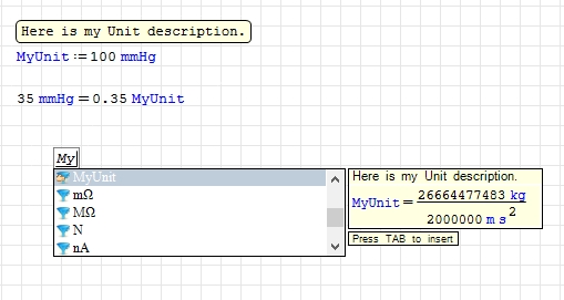

#3 Опубликовано: 07.08.2020 13:04:38
I think that the lang file are hardwired, no chance for ordinary users to add, you can just modify existing entries.
Thus, using the units.xml file lacks the chance of adding description texts. Also, this approach is non-portable. Your files won't work in an SMath installation without your particular units.xml.
You might use a snippet instead.
These are ordinary SMath files which can be embedded in any other file just by typing their name, usually as collapsed area region. And in ordinary SMath sheets you can define units with descriptions in whatever set of languages.
The advantage is that such files are portable. The disadvantage is that they aren't updated when you update your unit snippet.
This auto-update can be achieved using the plugin-mechanism. It also includes portability, as the dependence on plugin and version is stored in the sm file and any user with an installation lacking this plugin will be offered to download it from the online gallery in the extension manager.
Of course, you can ask Andrey to include your units in the next update. That would be the easiest and most straightforward way for the users.
This, however, would require you to stick to common standards and not to invent arbitrary units of convenience.

#4 Опубликовано: 07.08.2020 17:26:15
Hi. I agree with Martin. Also, in the standard way to introduce new units in SMath, you can add your own unit description, again, in the standard form.
I don't check if you can add different description for different languages.

#6 Опубликовано: 12.05.2023 13:16:02
⚜ Kenny Lemens, P.E. ᵂᴵ
Greetings,
So my question is, what am I doing wrong? What do I need to do to get Smath to accept my additional unit descriptions?
Simply do not reference the *.lang file; that is: do not specify an 「id」. Instead, I would advise you to just declare a 「title」 field.
If you inspect the 「Constants.xml」 file, you will notice the constant "ε.0" does not reference an id, but just defines a 「title」 of value "Vacuum permittivity"; the 「title」 field IS the value that is displayed as the SMath unit description.
    <add factor="8.85418781762039" exp="-12" connection="{A^2*s^4}/{kg*m^3}" [h]title="Vacuum permittivity"[/h] lang:rus="Электрическая постоянная">
      <synonym name="ε.0" />
    </add>
    <add factor="2.04548" exp="3" connection="(kg/{s^2*m})^0.5" [h]id="612">[/h]<!-- id='612' : Hildebrand, solubility parameter -->
      <synonym name="hildebrand" />
    </add>
