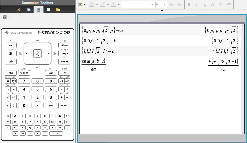

Hi~ I'm studyng building structural analysis.
When I calculate the displacement, I have to use list calculation like below using Ti nspire.
I would try this way in smath studio, but failed.
How can I calculate in smath studio?
thank you for your help.

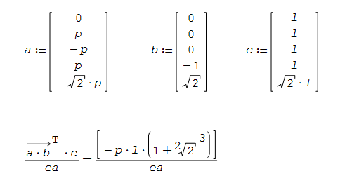

#2 Posted: 2025/12/7 09:23:36
StvMath
StvMath
44 likes and 1 dislikes in 71 posts.
The following uses vectors rather than lists:
You beat me to it by seconds!
Edited 2025/12/7 09:24:32
kimkim 2025/12/7 14:32:35
#3 Posted: 2025/12/7 09:29:24
kimkim
kimkim
0 likes in 9 posts.
Thank you, StvMath.
I've just found the solution, but I think your way is more efficient than mine !!
Thank you again.
Edited 2025/12/7 09:29:46

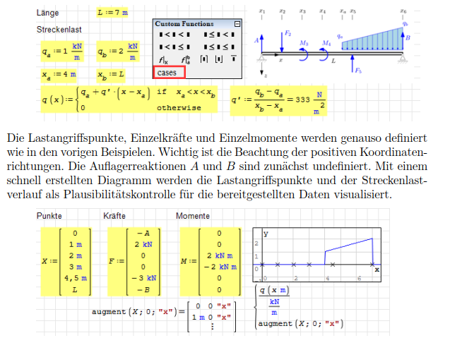

#4 Posted: 2025/12/7 12:34:43
1,355 likes in 2,271 posts.
I have just submitted a book on Engineering Mechanics with SMath Studio for publishing. It is to appear early next year. The examples are already available at Github https://github.com/sn-code-inside/Technische-Mechanik-mit-SMath.
See example 5.5.
Edited 2025/12/7 17:19:11
5 users liked this post
sergio 2025/12/7 16:48:11, Alvaro 2025/12/8 08:52:29, Davide Carpi 2025/12/8 10:42:01, ioan92 2026/4/12 09:56:46, kimkim 2025/12/7 14:32:30
