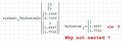

![2015-12-22 00_30_50-SMath Studio Desktop - [Utilities%20Matrix%20Treasury.sm_].png](/zh-Hans-CN/files/Download/2gEY8v/2015-12-22-00_30_50-SMath-Studio-Desktop---[Utilities%20Matrix%20Treasury.sm_].png)
Thanks Davide for visiting and commenting. The "Why not nested" is simply because on closing,
either XP or Smath don't save the work sheet settings, completely.
