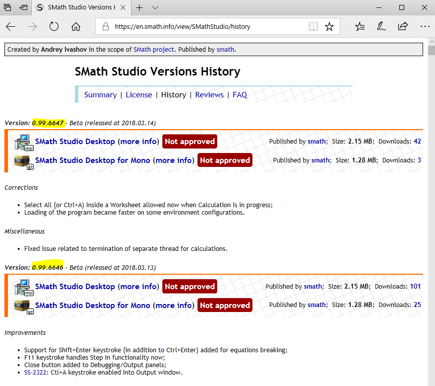

uMath Files Plugin appears to be broken with new release.
#3 Posted: 2018/3/13 14:58:12
2,340 likes in 4,041 posts.
Thank you! Fixed and new plug-in version uploaded.

The following SMath Studio nightly builds are marked as NOT APPROVED and will not be suggested to download to anyone anymore: 0.99.6646, 0.99.6647!
