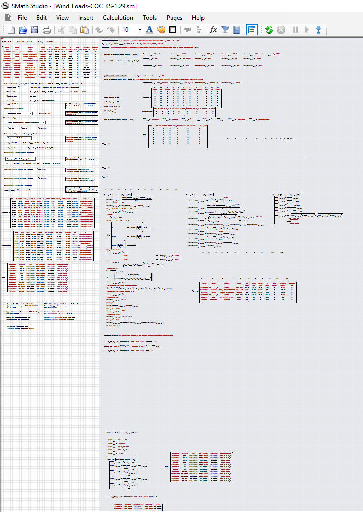

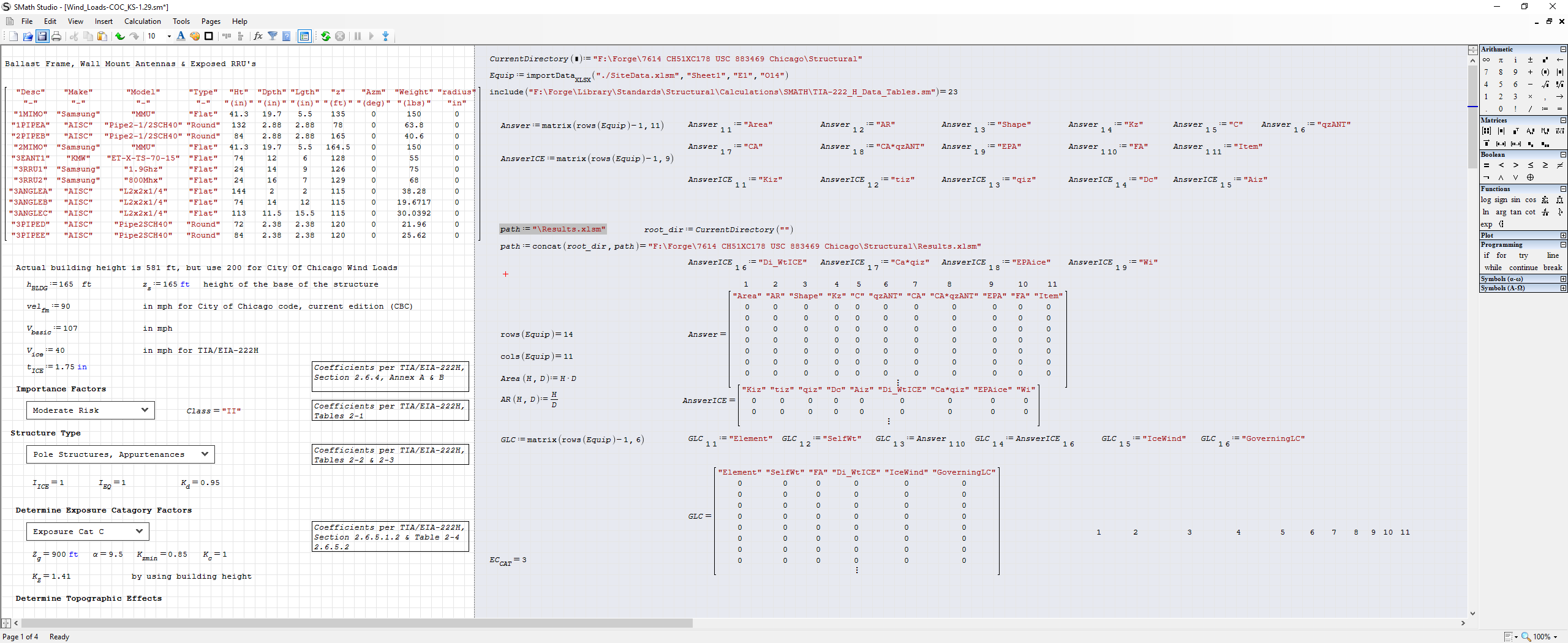

I am trying to understand how to do this. Here are some screens- there are a bunch of linked pages.
Even though we are a bit of a 'family' here and we freely share things, one of the pages uses data and
equations from an ANSI/model code that I am not supposed to redistribute so I don't want to toe that line.
There are some of those proprietary equations in here too, but I will try to move them out later.
But MY top level page is attached.
I want to inspect the sections/lines below the arrows I inserted.
As I understand it, in order to get there, I have to step-wise evaluate to that point. When I want to make
an edit, I have to interrupt the processing and restart it from the beginning. In this case, the processing
jumps around a LOT because of the way i set it all up.
If I put test:1 in there, I am not sure how to jump to that point. I use the Step Into (F11) button and the
Continue button to get to where I want to get to.
Whole page-
Wind Loads-COC.sm (121.51 KiB) downloaded 1023 time(s).
Screen at a time-
Step 1 is to evaluate the whole worksheet
![2018-09-08 01_54_17-SMath Studio - [Page3_].png](/zh-Hans-CN/files/Download/PCq3hR/2018-09-08-01_54_17-SMath-Studio---[Page3_].png)
Step 2 is to set the breakpoint
![2018-09-08 01_54_33-SMath Studio - [Page3_].png](/zh-Hans-CN/files/Download/qgqKTM/2018-09-08-01_54_33-SMath-Studio---[Page3_].png)
Step 3 is to trigger the evaluation of the block, by defining something before that block
![2018-09-08 01_56_04-SMath Studio - [Page3_].png](/zh-Hans-CN/files/Download/ReAyar/2018-09-08-01_56_04-SMath-Studio---[Page3_].png)
Once you find something wrong, edit it and set the breakpoint, then define again something before the block
![2018-09-08 01_56_42-SMath Studio - [Page3_].png](/zh-Hans-CN/files/Download/rFWd2e/2018-09-08-01_56_42-SMath-Studio---[Page3_].png)
(and repeat... anything above the yellow variables is kept from the first evaluation)
