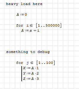

If you want to calculate sin(30) at the end of a greedy work sheet,
and "Auto-calc" ON, it will just calculate sin(45)=
You can attach your document for doctoring

As for now I think the only way it's to insert a dummy operation in the point you want the debug starts (f.e. you can define test:1 and everything will be recalculated from that point onwards)

More simply: copy/paste on new page what belongs to debugging,
or disable all stuff that does not belong to debugging.
Modular programs are easier to debug piece wise.

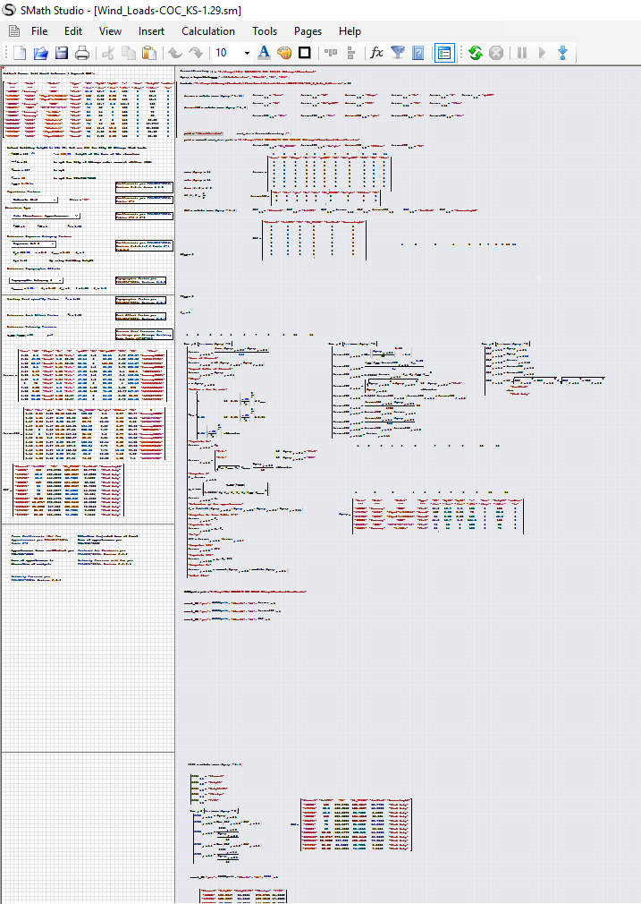

I am trying to understand how to do this. Here are some screens- there are a bunch of linked pages.
Even though we are a bit of a 'family' here and we freely share things, one of the pages uses data and
equations from an ANSI/model code that I am not supposed to redistribute so I don't want to toe that line.
There are some of those proprietary equations in here too, but I will try to move them out later.
But MY top level page is attached.

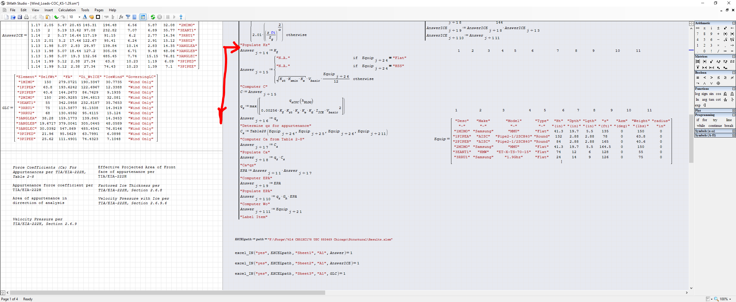

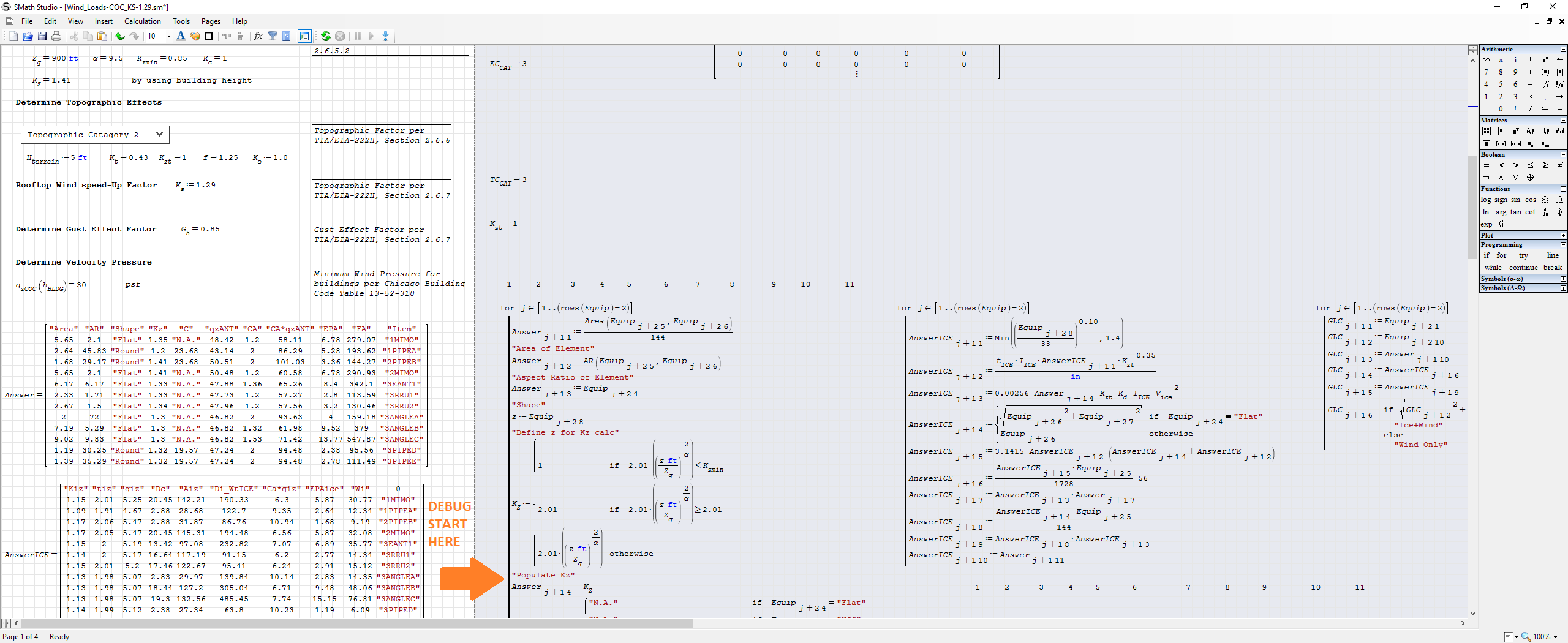

I want to inspect the sections/lines below the arrows I inserted.
As I understand it, in order to get there, I have to step-wise evaluate to that point. When I want to make
an edit, I have to interrupt the processing and restart it from the beginning. In this case, the processing
jumps around a LOT because of the way i set it all up.
If I put test:1 in there, I am not sure how to jump to that point. I use the Step Into (F11) button and the
Continue button to get to where I want to get to.
Whole page-
Wind Loads-COC.sm (121.51 KiB) downloaded 1191 time(s).

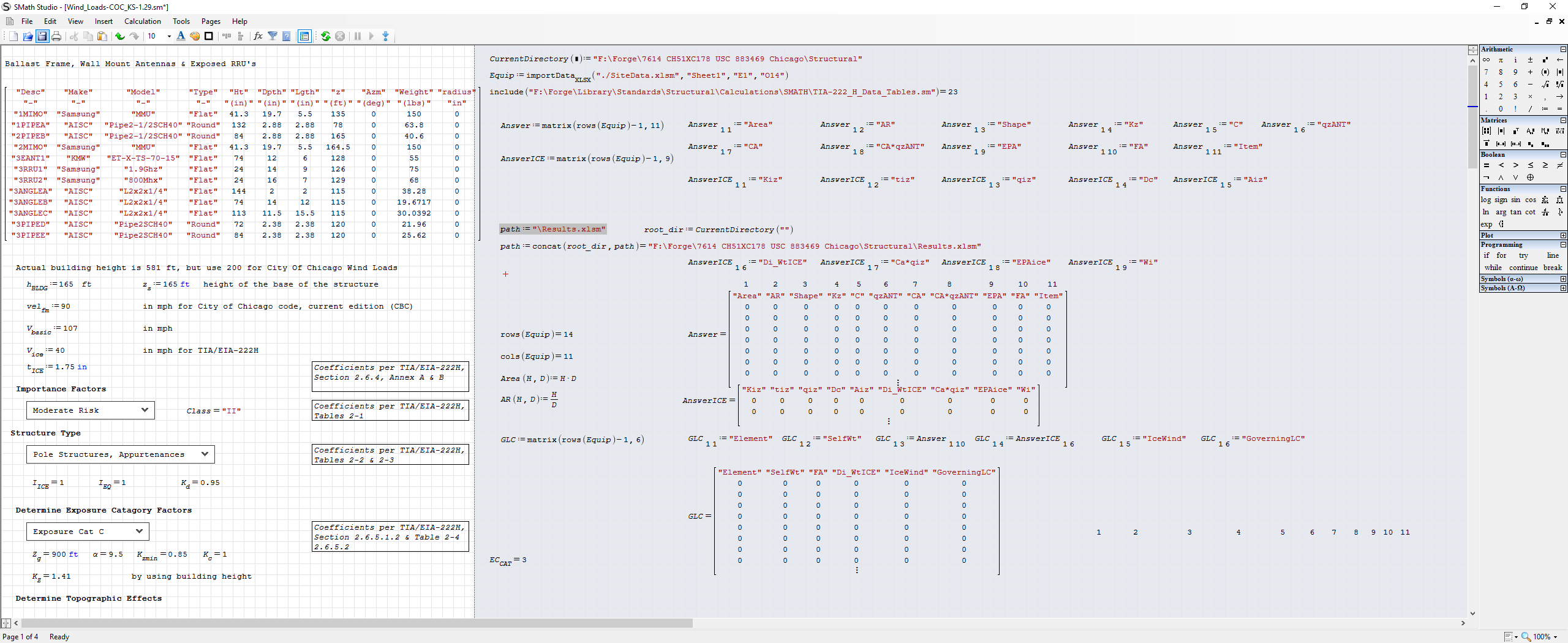

Screen at a time-
