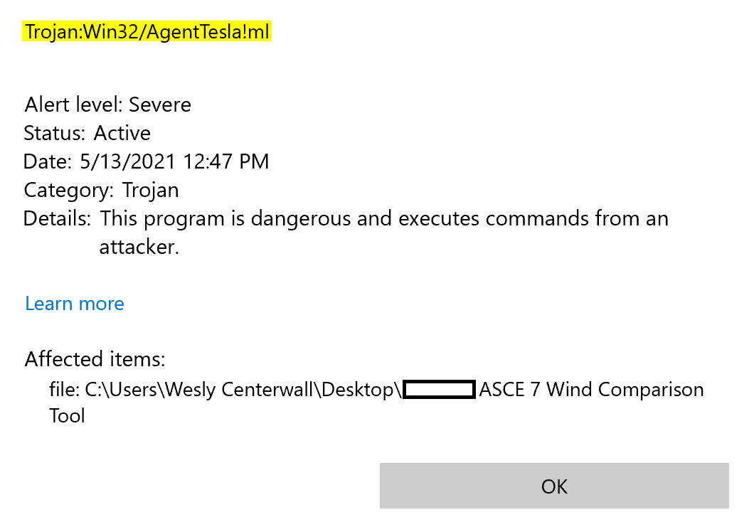

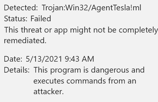

I'm getting a virus issue when I save an exe in the full version.
The file seems to work fine on the computer I created it on, but when I send it to another PC, windows defender blocks it and detects the trojan Win32/AgentTesla!ml.
Not sure how to handle this. I can't distribute exe files like this.
*when I send it in a zipped folder via email.
False positive. Anti-virus software sometimes do not like when programs creates other programs. You have to contact to your anti-virus vendor or exclude such programs from scanning.
Unfortunately I can do nothing with it.

AgentTesla is a quite specific Trojan, usually in the cases of false positive triggered by suspicious behavior the issue is labeled with something like "generic.win32". The detection is based on euristic algorithms thus not so straightforward and just speculation, but the fact that is prompted by a popular antivurus but not noticed by anyone (AFAIK) might indicate a system infection rather than a program issue.

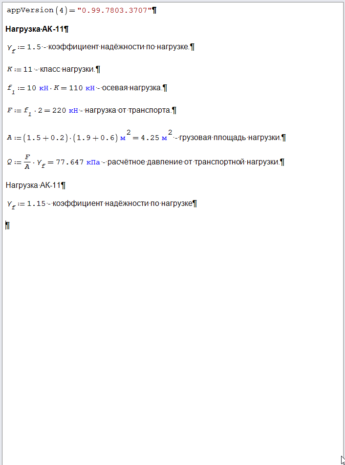

Problems with copy and paste in document mode
#17 Posted: 2021/5/14 10:03:19
127 likes in 342 posts.
I confirm what is indicated by Denis, even in my installation
#18 Posted: 2021/5/14 10:40:27
2,340 likes in 4,041 posts.
Yeah, it is a known issue - copy/paste of content inside Text Region is not implemented yet (except simple text). I plan to handle it soon.
Thank you!

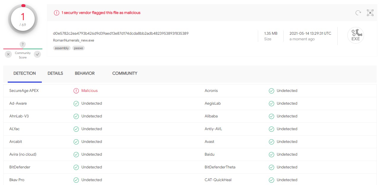

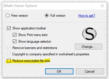

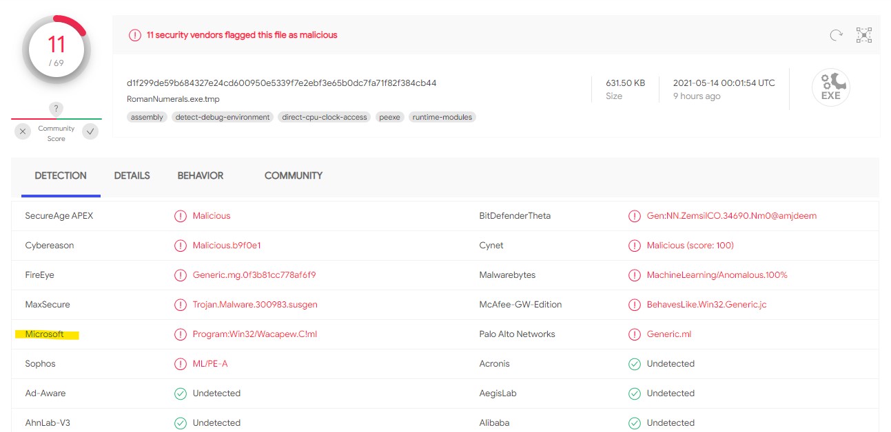

I have some good news regarding false positive detection! After a long night and morning I've found binary pattern which triggers some AVs to mark executables created by Viewer as malicious...
Knowing it I've added possibility to give AVs a fight! Unfortunately I have to disable compression of internal resources to do it, but I do not think it is so bad.
Please try a new SMath Studio version - it has the following checkbox (uncheck -> file size increased -> AVs are happy -> profit):
Here are results of testing the output result in VirusTotal:
Before
https://www.virustotal.com/gui/file/d1f299de59b684327e24cd600950e5339f7e2ebf3e65b0dc7fa71f82f384cb44/detection
After
https://www.virustotal.com/gui/file/d0e5782c2ea4793b426d9d39aed13e87d174dcda8bb2adb4823953893f835389/detection
#20 Posted: 2021/5/14 12:29:40
Just to mention: in my case file size without compression is 1.35MB (against to 0.6MB with compression). But using 7-Zip afterwards allows to make a size less than 0.5MB, which is good enough for delivering to other people.
