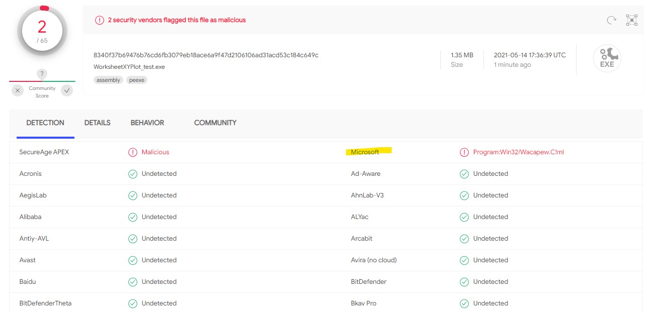

Here are the results with XY-Plot:
https://www.virustotal.com/gui/file/8340f37b69476b76cd6fb3079eb18ace6a9f47d2106106ad31acd53c184c649c/detection
This is really great, because it means that problem with MS AV only and this might be because of some difference between built-in plug-ins and third-party ones.
And I found one!
I do not sign third-party plug-ins with code certificate. And this is something I can actually fix.
Please give me several hours and I will enable signing third-party plug-ins and test everything. I really hope it will help!
