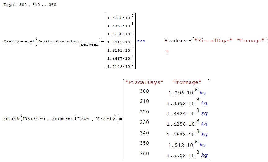

Thanks ...but can you tell me what is the wrong in this kg <> ton ...it should just reduce the power to 10 from 8 to 3 without changing the values
WroteThanks ...but can you tell me what is the wrong in this kg <> ton ...it should just reduce the power to 10 from 8 to 3 without changing the values

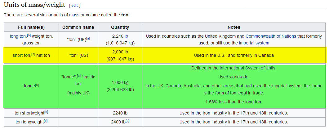

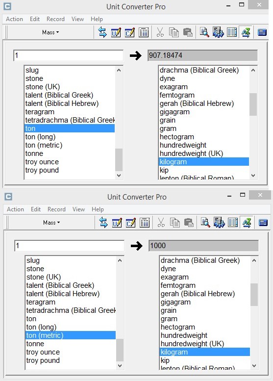

You have to use 't (metric ton) because 'ton here is the US "short ton"
