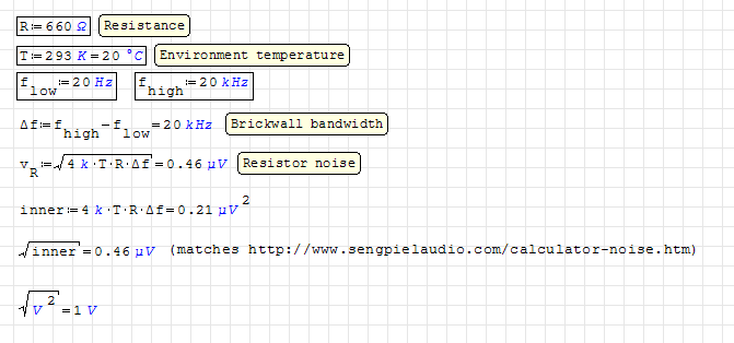

I had a worksheet that worked in the past, but now it doesn't, saying "operation cannot be performed with units", because it's sqrt(V^2)? But if I break it up into two steps it works:
resistor noise fail.sm (6.87 KiB) downloaded 1250 time(s).
yes, it works in the Nightly build. thanks.

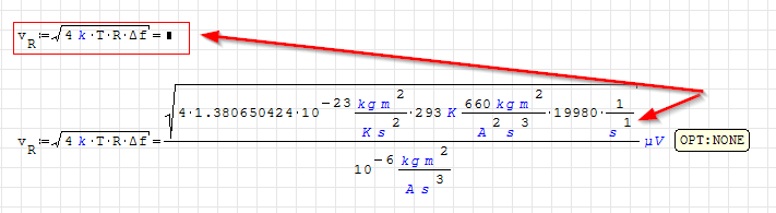

Actually, no, the original worksheet is not working, only the copy that I uploaded
Basic stuff.sm (11.77 KiB) downloaded 1214 time(s).
I've already seen this bug, sometimes comes to light...
when the SMath engine output unitary exponents on units, square root fails.
Refreshing the worksheet alternately works/doesn't works.
[EDIT] Added in the BTS: SS-177
