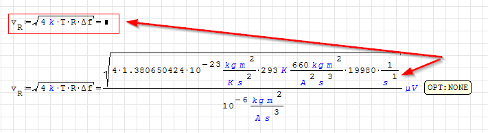

I had a worksheet that worked in the past, but now it doesn't, saying "operation cannot be performed with units", because it's sqrt(V^2)? But if I break it up into two steps it works:

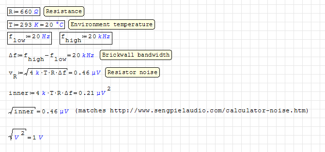

#2 Опубликовано: 14.07.2014 12:43:55
Works for me with SMath 0.97.5301, but I see you are using 0.97.5154
Could you try to open your file with the latest Nightly build?

Actually, no, the original worksheet is not working, only the copy that I uploaded
Basic stuff.sm (11,77 КиБ) скачан 1372 раз(а).
#5 Опубликовано: 14.07.2014 13:23:39
I've already seen this bug, sometimes comes to light...
when the SMath engine output unitary exponents on units, square root fails.
Refreshing the worksheet alternately works/doesn't works.
[EDIT] Added in the BTS: SS-177
